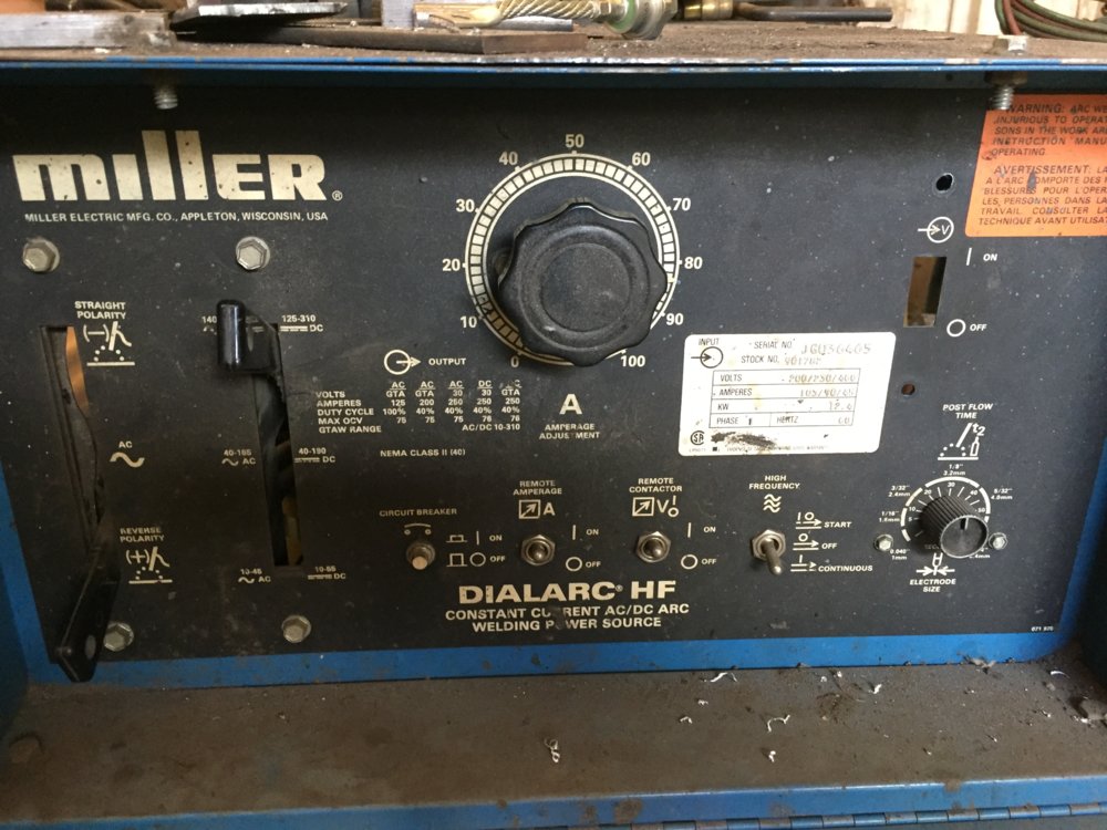

Got problem we can’t solve at the shop have a Miller dial arc cant get it to start a strong arc replaced the contact switch and now I diodes in it anything else to look at for this issue?
Scratch that had a diode bad getting hf arc now but the damn Bryant 60amp switch is broke so hot wiring this beauty I reckon
