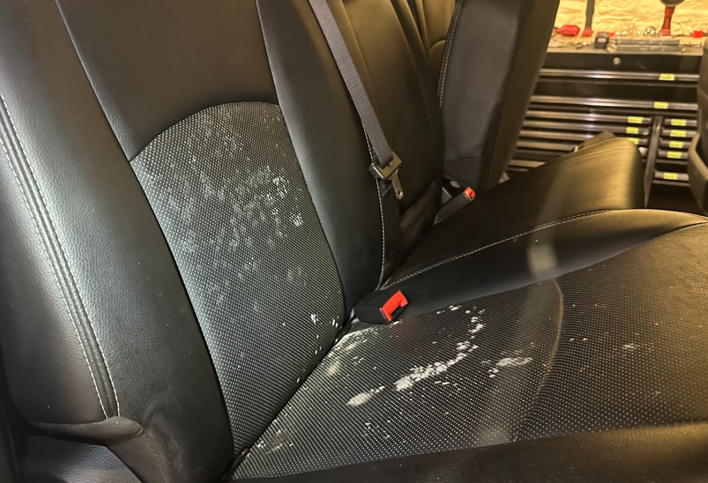

@Blaze are you talking like this, but more:
My truck had this happen after I busted the 3rd brakelight and water unknowningly got in the cab and was hanging out under the rear seats. Same deal with heat and humidity helping it. I cleaned it with something but I don't remember what. Fast forward to this year and the windshield getting busted while the truck was parked, same thing happened again. This time I hit it with Mold Armor and let it soak for a bit. It's been in my air conditioned shop since, so I don't know if its gonna come back, but I feel better about it this go round. Are you 100% sure there's not a leak somewhere? I know my Volkswagens have been bad about having clogged gutter/drains causing water to accumulate under the front floor, and if the vehicle is driven frequently enough, it sloshes around enough to dry it out and you won't know it.

Yeah, just like that, but way more. I think one of the cars does have a leak in the trunk, but it is literally every single car I park down there. I have a lot of junk, but no way they all suck that bad. :lol:

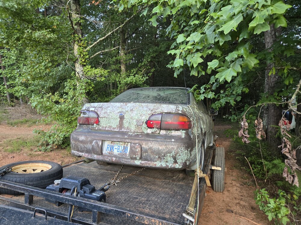

Would you recommend this same solution for mold on the outside? Had a truck that was parked under trees for a few years. Now that its parked in the sun, itll still get a green film growing on it over time.
Yep. Depending on the severity of the mold and the condition of the paint I might go leaner. 1 Part white vinegar, 3 parts water. Then go back with some kind of a sealer wax. You'll likely remove any remaining wax during the mold removal process. Or if its a shitbox, just send it.
