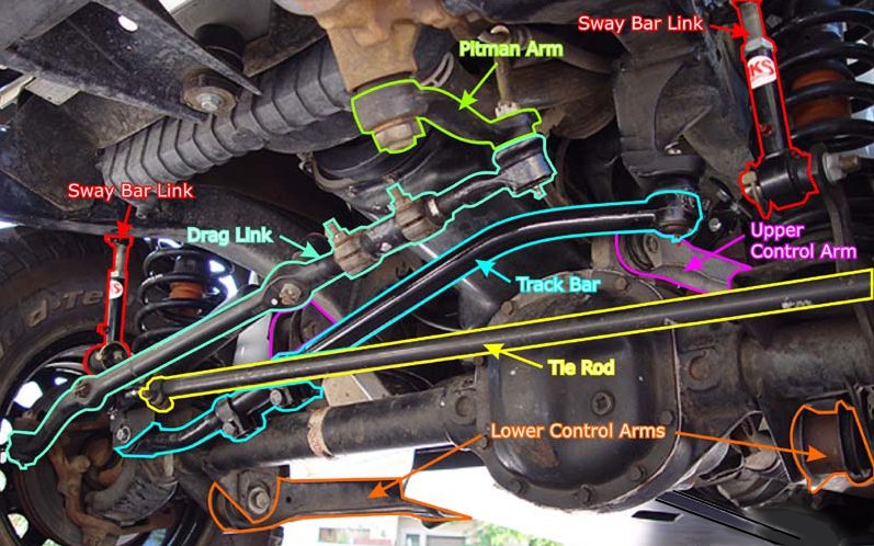

Track bar- Check the bolts at both ends to see if they are all tight. Check the mounting holes, as they can become wallowed out. Check the bushings, rod end or tie rod end for wear and tear. A good way to check is to enlist the help of a fellow Jeeper. Have them turn the steering wheel back and forth quickly as you are in front of the jeep looking for movement. Do not turn full lock to lock, just rock the wheel back and forth. (8 out of 10 times the track bar is the culprit!)
Alignment- Make sure you have had your Jeep properly aligned, especially after any kind of lift kit has been installed.
Tires Balanced- Make sure your tires are properly balanced. Not all tire shops are the same, and its often been my experience that unless you know your shop very well, you might want to get a second opinion.
Tie rod ends, ball joints, wheel bearings and control arm bushings. You are looking for movement where there is not suppose to be movement.
The main idea here is to check all the moving components in the operation of the suspension or steering.
Now that you've diagnosed the culprit causing Death Wobble, you should slowly drive your Jeep to the nearest offroad shop and have your faulty parts replaced.
