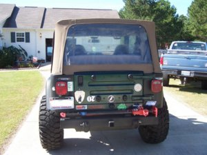

This is a stock bumper that i mounted d-rings and a hitch adapter on. So its still sock. I welded two 9/16 bolts to top of bumper and two nuts and two washers holds it tight. I go wheeling with it there and it has never loosened up even in the Uwharrie Rock race last year. Simple and very cheap.
i have the spare tire still mounted. jack won't fit.

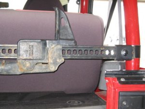

There's an easy enough way to mount it to the rear Rollbars at the tub using Pipe Clamps, carriage bolts and Wing nuts. I don't have a picture as it was my buddies TJ. but it's a good place that's out of the way.

I did mine this way after seeing Joel's setup. Only costs about 4$, the jack is out of the weather and out of the way. The top fits fine and the jack doesn't touch it. And just to elaborate, the pipe clamps are actually the clamps used on chain link fences. Open up the clamp, put it around the bar, throw in a carriage bolt, put on a regular neu to hold it tight, slide the jack over the long bolt (through one of the many holes in the jack) and tighten it down with a wing nut.

This is the best pic of the pipe clamp setup that I could find.
