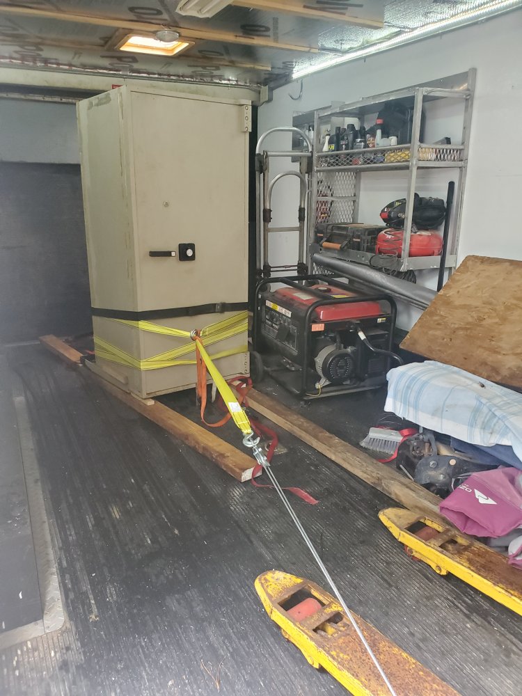

I need some ideas for getting a safe I just bought into my house. I did a ton of research before purchasing this safe but after calculating the weight it turns out its about 600lbs heavier than I thought. The total weight is about 2500 lbs.
The safe is in the back of my enclosed trailer where it almost went through the floor while attempting to move on a pallet jack. I didn't think about how weak the plywood floor is with such huge gaps between the supports.
Anyway, I have access to a backhoe with forks and should be able to get it out of the trailer and onto the concrete porch but I don't know what to do from there. I called a few localish movers who do not want to move anything this heavy. A safe store in greensboro quoted me $900 to make the 1.5 hr drive and that is more than I spent on the safe.
From the concrete porch there is about a 6" step to get through the door. Once the safe is through the door I just want to slide it along the wall about 20ft and there it will live, sitting as close to the block foundation as possible. The floor is hardwood and I am pretty sure it can handle the weight, but let me know if anyone disagrees.
I've researched a lot of forums where people moved safes but they were all half the weight of this one or less. A popular idea seems to be golf balls or pipe rollers but I've not found anyone who used rollers under a safe over 1000 lbs.
Right now my only idea is to build a platform on the porch, set the safe on it then slide it in by pushing it with the backhoe bucket. If that works and the safe clears the door I do not know how to move it perpendicular to the door opening and get it to its resting place. Any ideas?

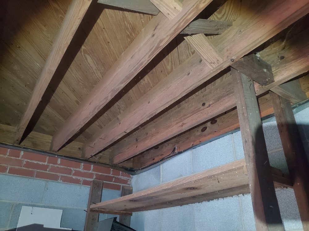

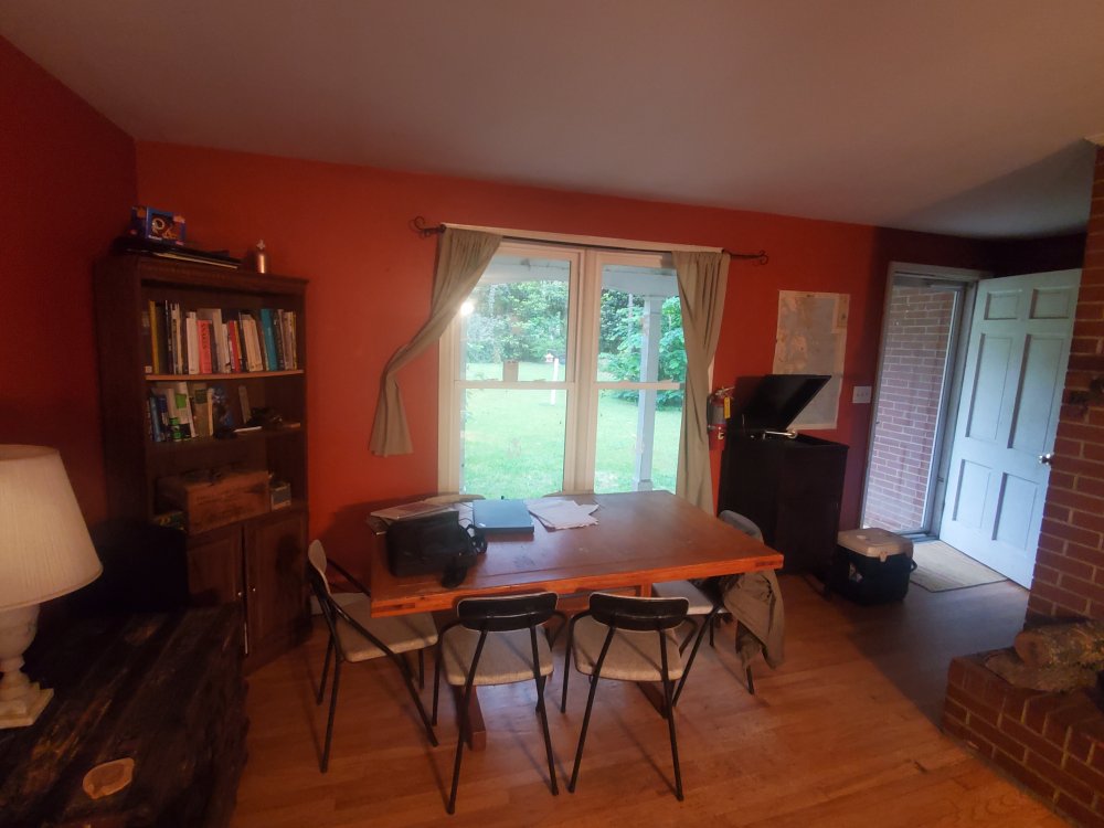

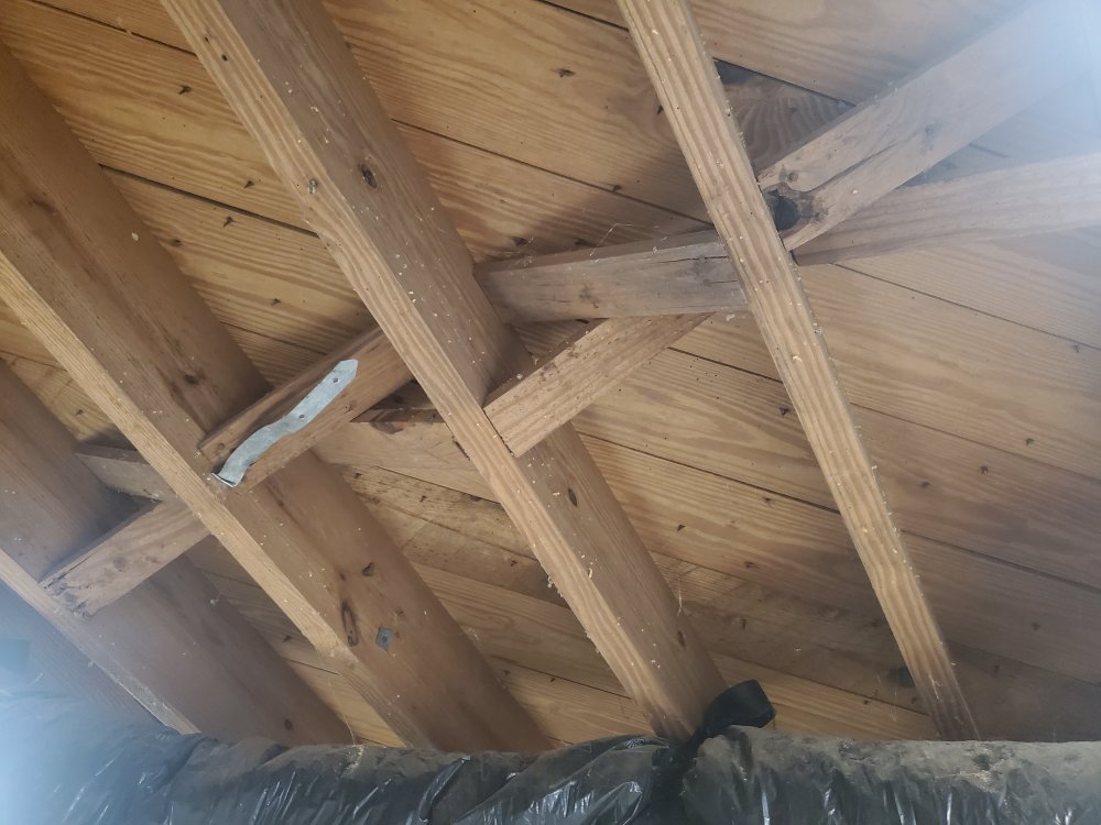

This corner is where I'd like to put the safe. It is directly over the concrere slab in the basement. If I just run some beams from the concrete slab to the joists should that be sufficient to hold the weight?
Can you confirm the joist depth and on center spacing? What is the footprint of the safe? Is it point loading at the corners or flat?
You also need to consider the weight of the safe fully loaded, I imagine this won't be full of feathers. You might add another 1,000 with guns and ammo if you fill it up.
You might be able to make it work, but it will likely damage your floor, and might lead to some foundation damage.
Joist spacing is 11.5" and joist depth is 7 1/4" ish. The platform of the safe is 25.5 x 27.5 and is flat.
2x8's, even at 12" O.C. are not going to carry that load, thinking it through, you also need to take into account the span of the joists from where you start moving this to where it ends up, if it is a long, unsupported span your floor could buckle during the moving process. Best case you span 3 joists, worst case you straddle 2.
I can check some span tables on Monday, but you are looking at 1,000psf load (full safe) on floors that were probably designed for a 50psf load.
This is where I wanted to go with the safe. From the door to the corner where the bookshelf is. The joists run left to right. Is there anything I can do to reinforce the 2x8s to support the short journey adequately? I am willing to add joists, bridge them to each other, add 4x4 or 6x6 posts every few feet the whole way...
