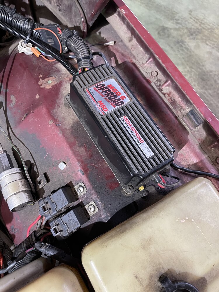

So, I consider myself a pretty stupid fella but this is making me feel really stupid. I feel like I need a sounding board or someone to say “yeah mine did that and it was XYZ” so I’ll feel a bit better.

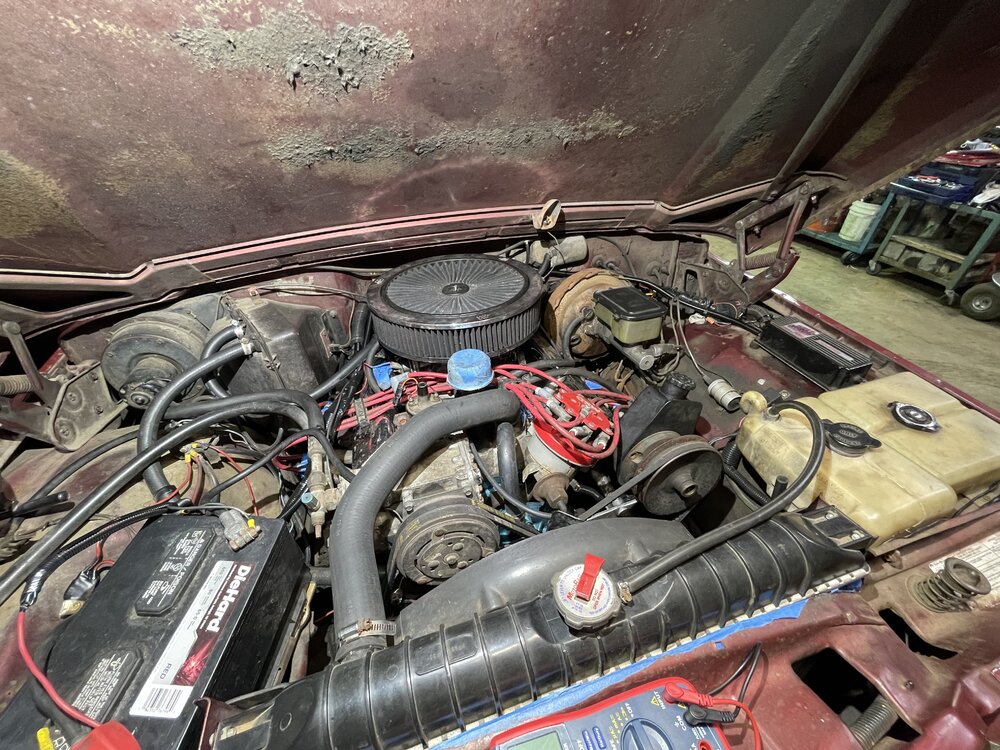

My 84 Grand Wagoneer randomly loses spark when it’s up to temperature and normally when off the throttle or coming to a stop. I know it’s actually losing spark since I’ll hook a test light to the coil and after it sits for a few, it’ll regain it and fire back up, only to stall again a few minutes later.
I went through every connection on it earlier and moved a few wires around to make sure connections were good but she still stalled, albeit after a longer amount of time running (35 minutes or so)

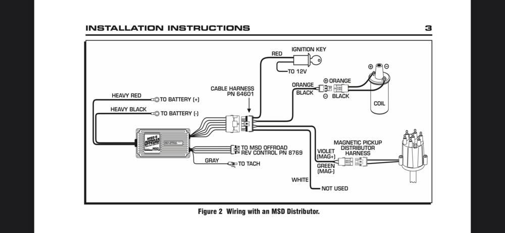

Box is hooked to the battery, pickups are clear of the coil power wires, box should be getting 12v of power when the ignition is in the crank/run position. I’ve done the spark test with a paper clip to confirm what it should look like when working, but I need the bastard to actually cut off when warm so I can do the procedure and check for spark. If I can’t get spark when it’s acting up, I’m going to check for voltage at the ignition trigger wire, and if it has it, I’m going to assume the MSD box is getting hot or something internally and losing the spark signal.
Is there anything else I can check? Or anyone just had a MSD box go bad? I’ve tried a new coil, smacked the box a few times, jiggled wires, the ignition switch, etc. Nothing I have done as of yet has made it cut off unless it wants to.
I am pretty sure I have one of those -6 boxes in my parts pile. It'll be a couple of days, but I can check, and if I find it, you can swap/test with it. If you don't hear from me by Thursday evening or so, drop me a PM and remind me.
So, I finally got a chance this evening to test the box out, she bad. It’ll lose fire for 5 or so minutes till the box cools off and it’ll light back off.
