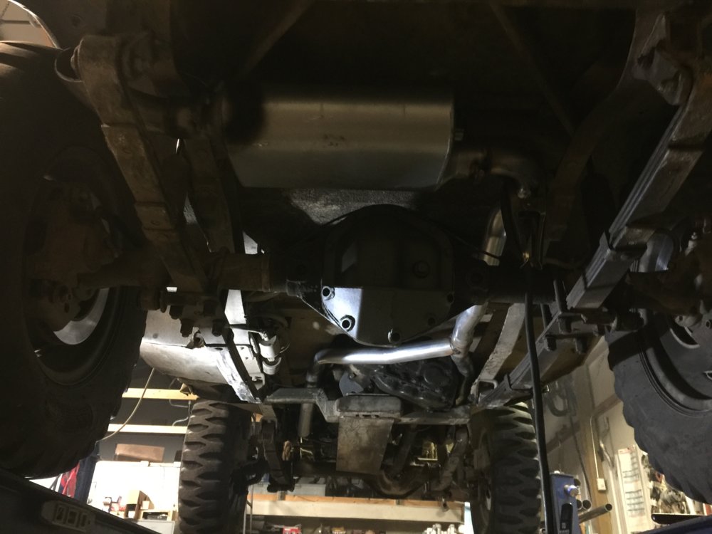

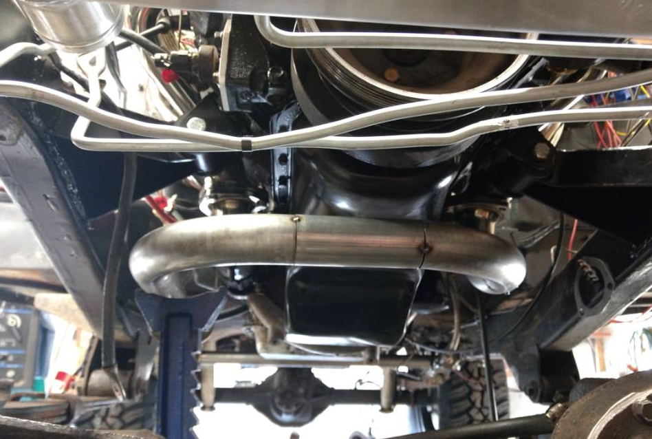

Just looked at your build again. You have a LOT more room than I do. This is what I have currently mocked up.
Driver side. Has to clear the slave cylinder.

Passenger side

@getstucksome came over last night and offered another set of eyeballs. We decided to route the driver side around in front of the oil pan and tie it into the passenger side. I have just about got it mocked up and it looks pretty good. I did have to take into account the front driveshaft and the Y pipe connection kicked my ass for about 1.5 hours but I have it tacked on now.
Final plan is to route everything down the passenger side framerail, dump into muffler right behind axle and then a simple turndown. This keeps the exhaust away from the fuel lines and allows me to use everything I already have.
