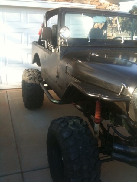

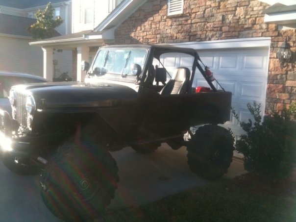

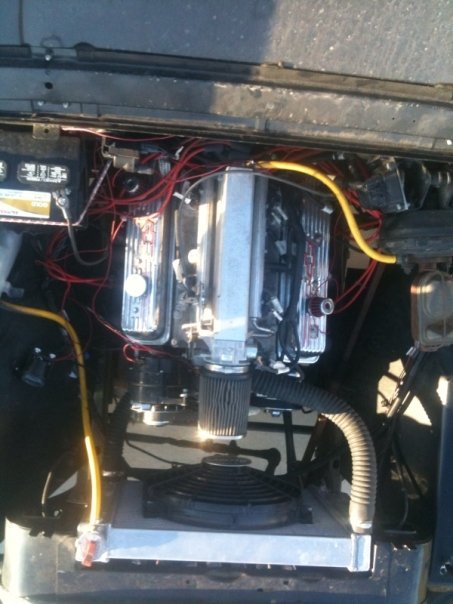

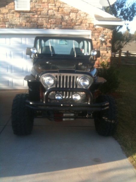

1981 Jeep CJ7 with a RamJet 350 V8 a SM465 heavy duty 4 speed
transmission and a Dana 300 twinstick transfercase that has a 4:1 gear
ratio installed. the axles are dana 44 front and dana 60 rear, with 4:10 gear ratios, open differentials and disc brakes all around. 15 gallon fuel cell sits behind the driver and passenger
seats and an Aeromotive Tsunami fuel pump with 100 micron and 10
micron filters supply fuel, rewired with a

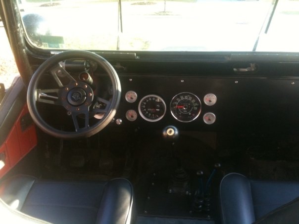

painless wiring kit, Autometer gauges, steering gear is a PSC xtra-
heavy duty cylinder assist tires are 35in Super Swamper TSLs on
16.5in rims. and The suspension is a
spring over conversion
Thats one tough 7! I been think of making some fenders like those and I really like the dash with the big tac in the middle. Nice ride man
Did you build it or is that Jay Fitch's old rig ?
