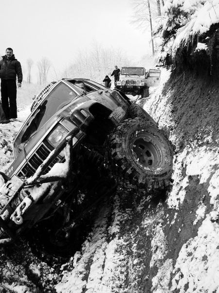

Hi everybody, I’m from Romania and I’ve made a few adjustments on my Cherokee witch I’ll be glad to share with you.
All this transformation started in November 2006 when I bought this car. The first modification was front bulbar with a warn xp 9000 on it, a lock right locker on the front axle, replace front brakes and axle shafts (the longer shaft was made from 2 pieces and I had that vacuum disconnect thing on the front axle), I also lift the car a little with 2”.
After one year of braking things and put dents on the car I’ve decided to build it a little higher and I put a 6.5” suspension on the front and a custom made 6.5” on back(I’ve used springs from a dodge ram 150, 2” shackle and a few spacers between springs and axle). The back suspension it’s harder but I didn’t brake the springs yet and I don’t think I will very soon. The dana 30 with vacuum disconnect was replaced by a reinforced dana 30 without vacuum disconnect and the dana 35 from the back was replaced by a Chrysler 8.25 with a lock right locker in it. Also I put 4.56 gears in axles.
The tires are 33 TSL Super Swamper on Beadlocks with 2” backspace.
I like it!

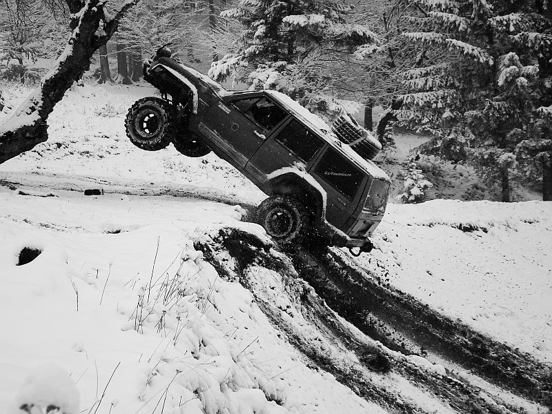

2nd pic kicks ass, lots of space beneath the tires.

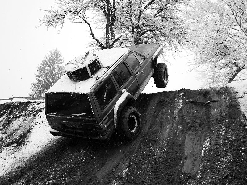

those are some sick angles you are driving on man! i wish we had snow like that in NC!
^yea i know! wish we had places like that here!!
