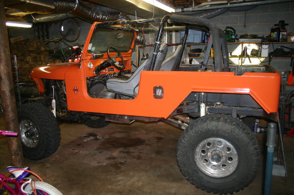

Well I got it painted and the 60 under the front also fuel injected. gotta finish some small stuff but its getting close to being finished.... well never mind that last little bit-- its a jeep.
Also gotta make some front fenders, cage--- anybody got a bender they will let me use:beer:
what you guys think.
specs
60 front, cut up 14bolt rear. homemade fuel injected 360, nv3550,d-300, linked rear, stretched to 110" wheelbase. everything from the door opening to the rear is fabbed. gas tank is mid mounted under the floor. kobota tractor paint. 37" disc. SST on some super:bling: moab wheels.

Looks good. Its got me modivated to get back to work on mine
Your rig looks great. I've been running Kubotas for about 25 years.:driver: I've heard 'em called just about everything.:lol:
Sure looks a lot like TOYOTA INDUSTRIAL ORANGE :flipoff2:
Raymond Red wasn't available ?
Looks good
Looks good
It is closer to TIO after I look at it. haha I can't get good Ray red, the crap they give us is orangish-pinkish-sorta-reddish. we just started getting some paint from valspar which is closer.
lookin good. you need to come wheel with us in the spring, when i get the new one done!
Kubota
Nice color, paint is cheap too, if you got it at Tractor Supply.

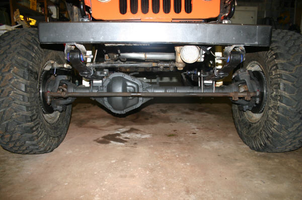

front axle
sa-weet, Dana 60 !!!!:beer:
yep!! after seeing that beast under your rig, I started looking. :beer: . I hope I get to try it out in a few weeks.
