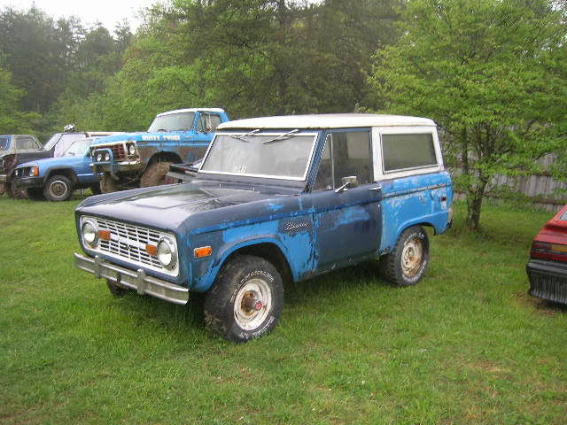

from this:

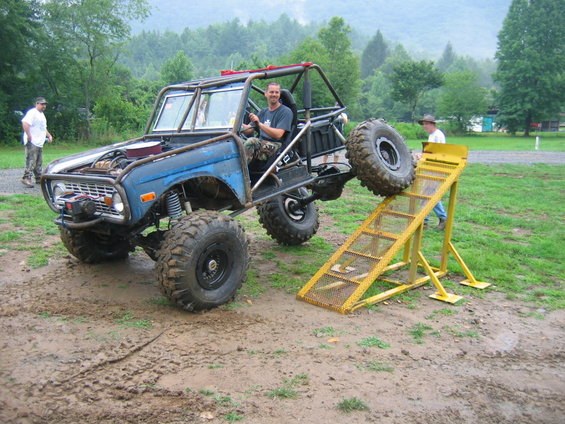

to this in under 10 weeks:

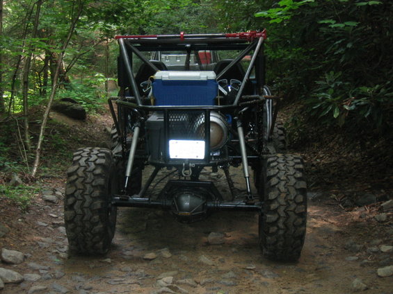

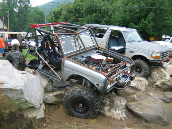

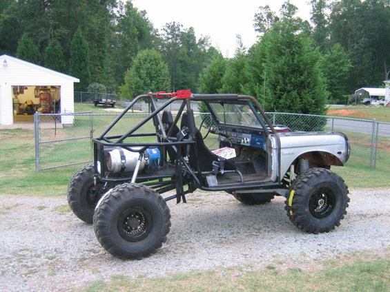

SPECS: 302/c4/dana20 , fullwidth one ton axles 4.88 gears with lockers and 35 spline shafts, 15/39.5/16.5 tsl mounted on stazworks double beadlocks with rock rings, psc ram assist and high steer arms all dom tubing, propane, 108" wheelbase, 5.5" cage long travel coils, cage extended radius arms in the front , 4 link with air shocks in the back , warn m15000 winch with amsteel 7/16 synthetic rope, corbeau factory 5 with rci harnesses, hi lift, cb , in dash mounted gauges.
