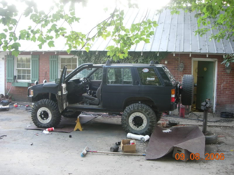

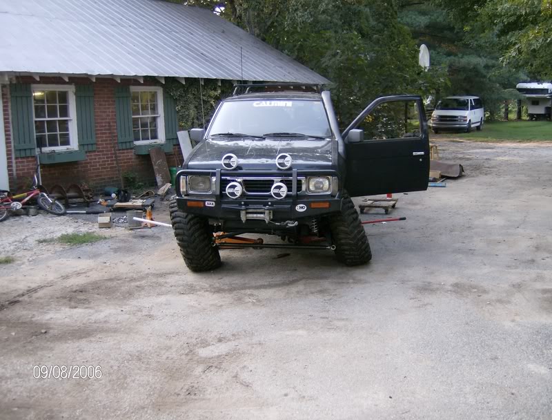

Thought I would post a pic or 2 of my Nissan. I am just finishing up a SAS when this shit happend. Those are 37's its sitting on.
5 minutes later

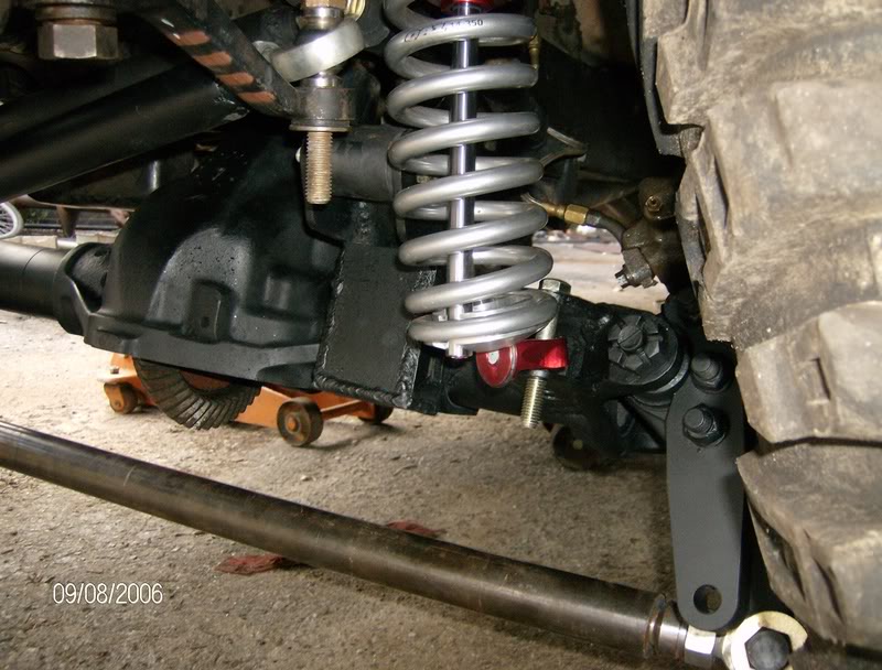

The tie rod and drag link had heavey tacks, but I had completely forgoten that the castor ajduster was only tacked. I was goign to weld it up but that day my angle finder broke trying to do that, I bought a new angle finder but it had slipped my mind. I guess this is why people make checklists. Luckily the coil-over people are pretty good and will fix them for $250ish.
Thanks, Its 4-linked with a panhard in the back and radius arms up front. I wanted to 3-link but I simply couldnt make it as low as I wanted. It have about 5-6 inches of lift. My next project will me pushing that rear end back about 3-4 inches and ditching the panhard in the back.
