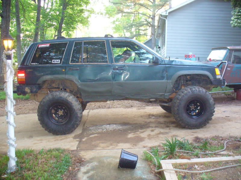

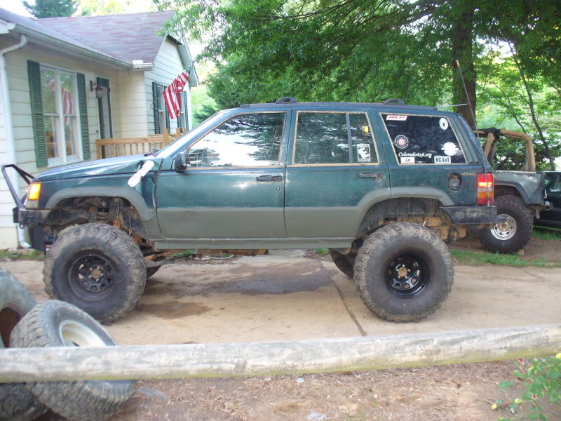

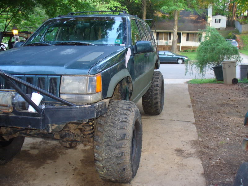

Well I put 36 inch Iroks on the ZJ . After that i noticed I needed a little more clearance so I added a set of 2 inch spacers front and rear, I also moved the front axle forward 1 inch and the rear back 3/4 of a inch ,I also did some more trimming on the rear wheel openings .
Here is the finished product
Looks good. What are the other specs on the ZJ? What axles u running?
1993 Zj 5.2 short arm rear ,long arm front ,
8.8 rear lock , lp 30 front locked 3.73 gear s going to regear to 4.56's soon , Has full cage inside as well
