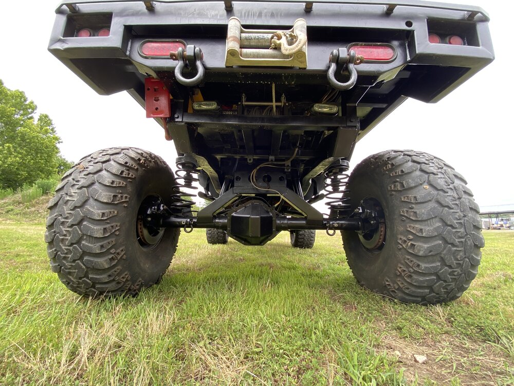

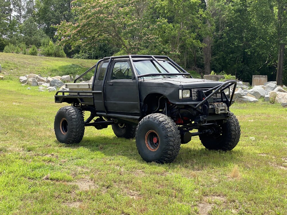

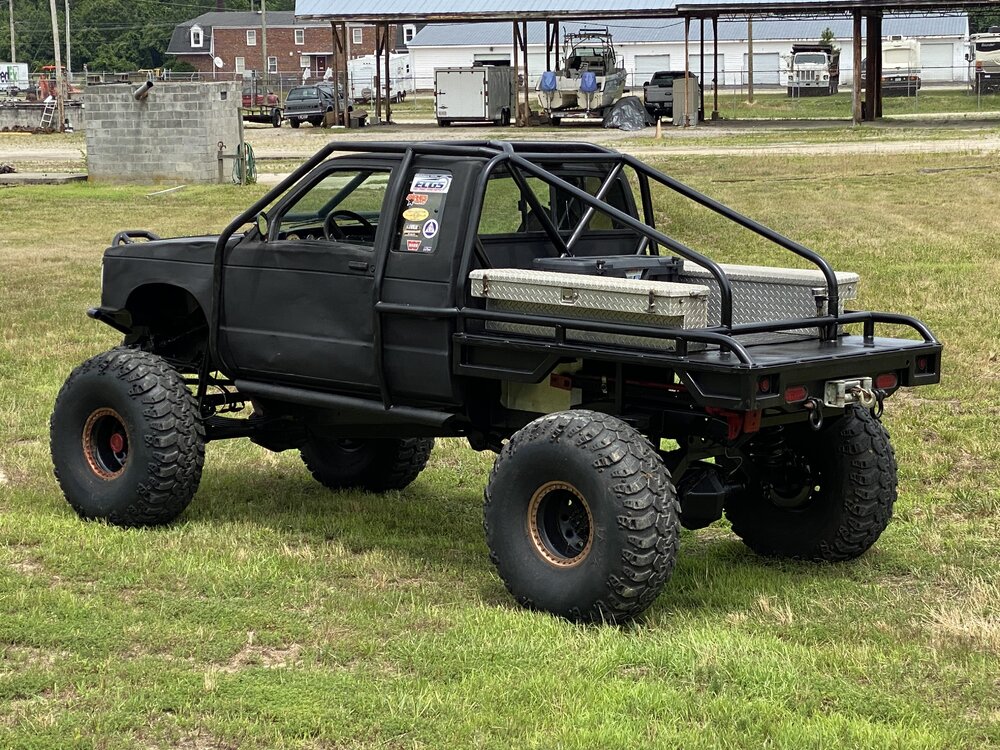

S10 cab on k30 frame.

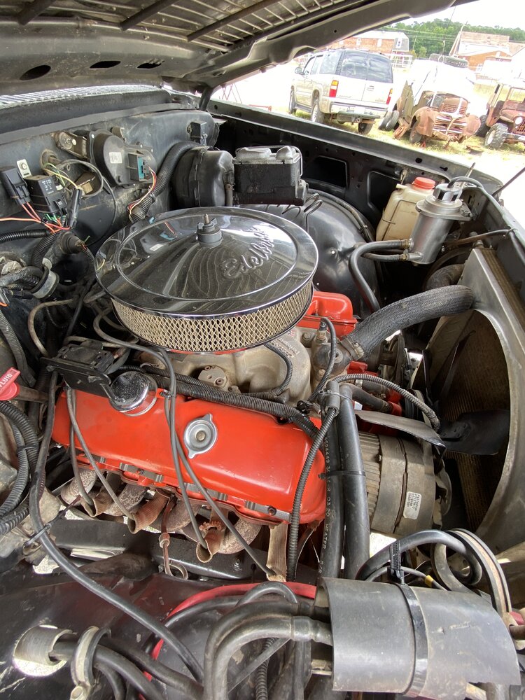

454 with Howell fuel injection. XJ poly tank mounted under the bed. It was rebuilt at some point by previous owner.
Fresh rebuilt th350. Np205 case.
60/14b. 5.13s and Detroit lockers in both. Front has ecgs 4340 35 spline shafts with (USA) stubs and Yukon super joints. Disc on both.
Psc steering with reinforced area around steering box and extra u-bolt to keep box on frame.
Leaf front, 4 link rear on coils.

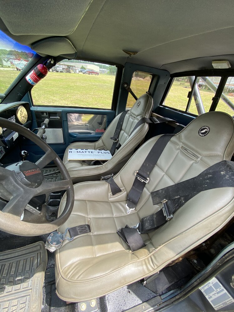

Corbeau seats on sliders. Front and rear winches, hi lift under bed. Two tool boxes on the bed sides and one poly tool box for fluids. Heat, radio, windshield wipers work.
Winters shifter with rock crawler gate.
Got this off the forum a while back, fixed and re fixed and upgraded it for my dad to wheel while following tube buggies around in the woods. It’s truly built to beat on all weekend, and carry tools and spares.

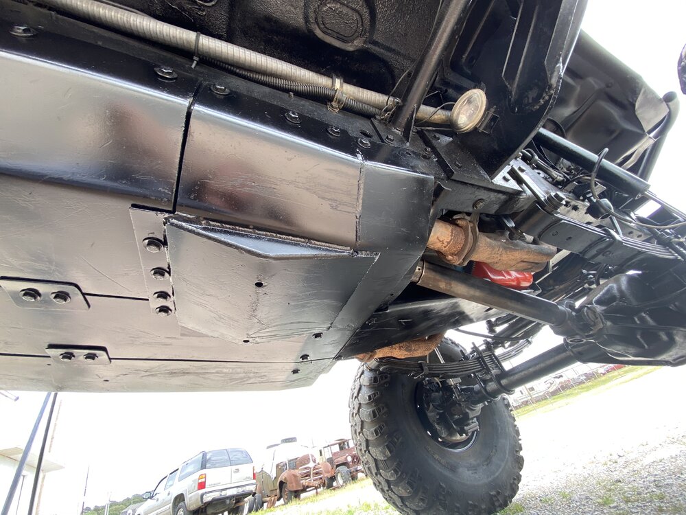

Full disclosure, one of the last trips out the converter started acting up. Got back, changed the converter, tested it, and discovered the trans was done. So while we had it apart, we cleaned and painted what we could so it would be clean and nice for new owner. My dad replaced this rig with a full tube buggy so it hasn’t been beat on since the last trip when the trans started acting up, hence why it’s all clean underneath.
