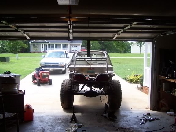

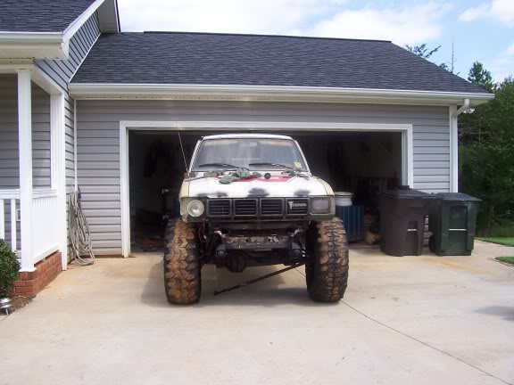

I had a big thread on the old board. I'm just gonna throw up some pics for now because hardtaco asked me to. I got some wheels from him, thanks. and some tires from another guy off this board.
Some specs as she sits.
Dual Transmissions are in and done.
Floor pan is 70% done.
Flat belly
Skid is 50% done.
Got all steering parts. Marlin arms, Thanks cburgin and some used track bars from a race shop with qa1 hiems for 100.00. Gotta cut and sleave them to lenght.

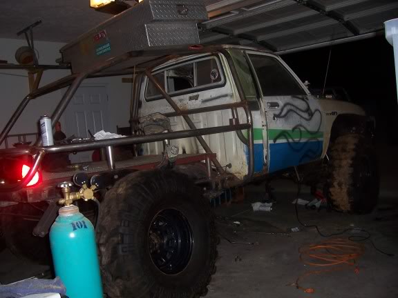

Bed is 95% done. Gotta finish building tail light covers and paint.
Exo is 50% done, got all the tube, just need to bend and weld. But I'll wheel it like it is.
Rears up front, custom drop hanger
F150s in the rear
D-shafts are done.
Gotta reset rear pinion angle.
Lots of little crap but its getting there.

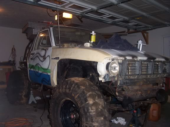

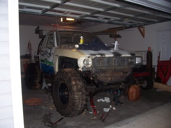

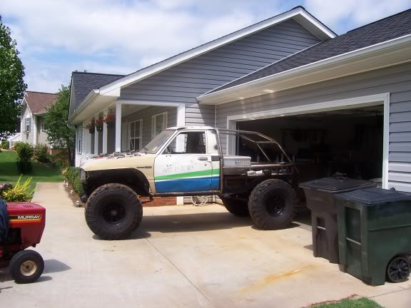

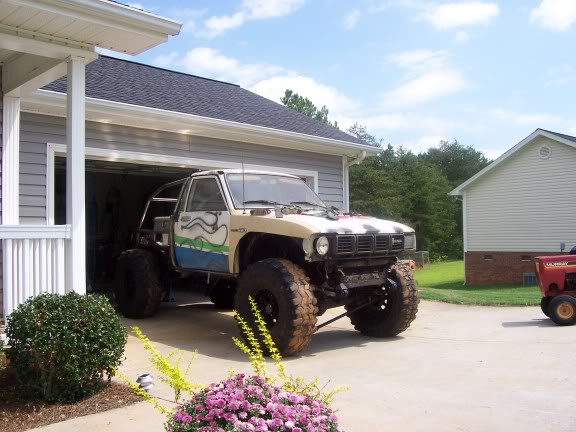

Heres some pics.
38x14x15 sx on 8" 2.5 bs wheels
1-2" lift
25" at belly
76 at roof
She's as low as I think you can do it without links.
I like your flatbed design man. I don't like many so that is cool to see.
I like the whole rig- even the spraypaint LOL
IT IS LOW for sure. good work. more updates

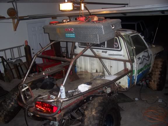

I really hope your not serious. Look at the bed, It has a hole for it behind the cab.
why waste bed space when there's plenty of room where the front bumper was? just build a little rack and poof you've got storage in the front!:rolleyes: I think hairy nut sack was kidding about putting the box on top of the cage though.
Anyway, the cage looks awesome and I love the almost fastback look of the top and the rear hoops around the lights.
