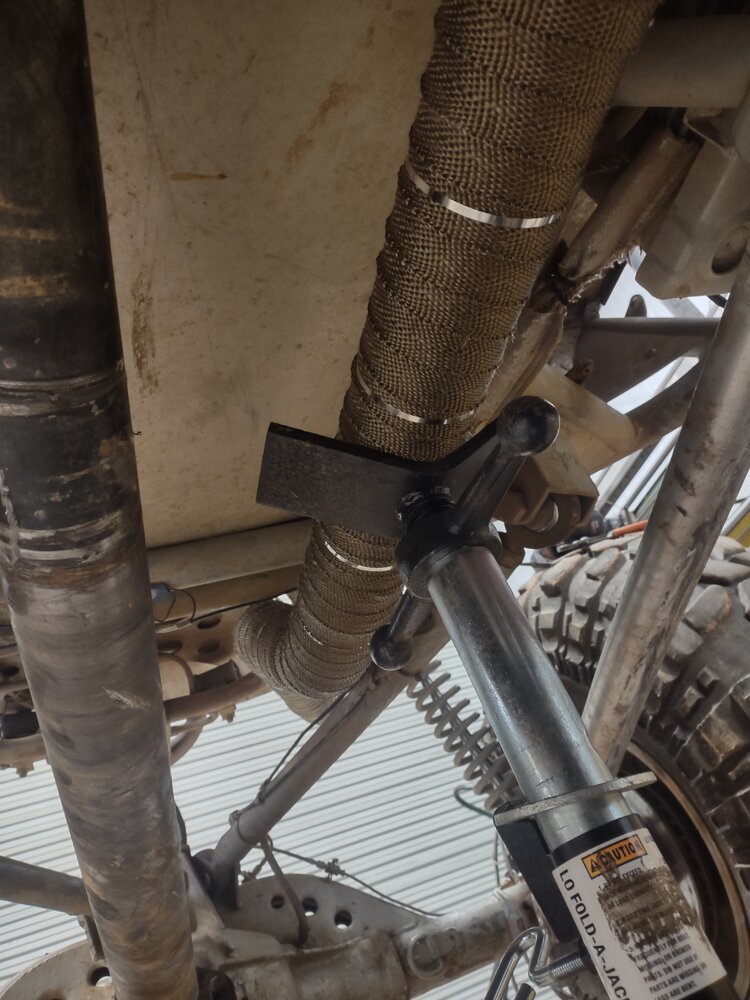

All hidden under this hateful itchy wrap is swagged 3 inch sections. Ridiculously more simple to fit and run. No where near as sexy if it wasn't heat shielded.

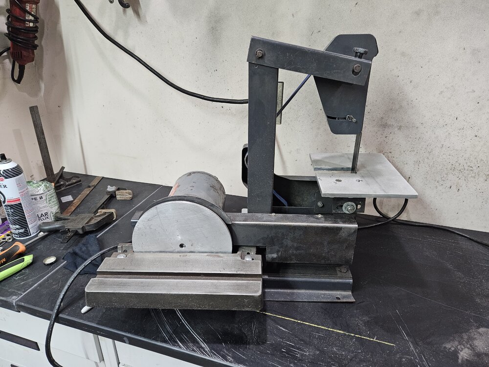

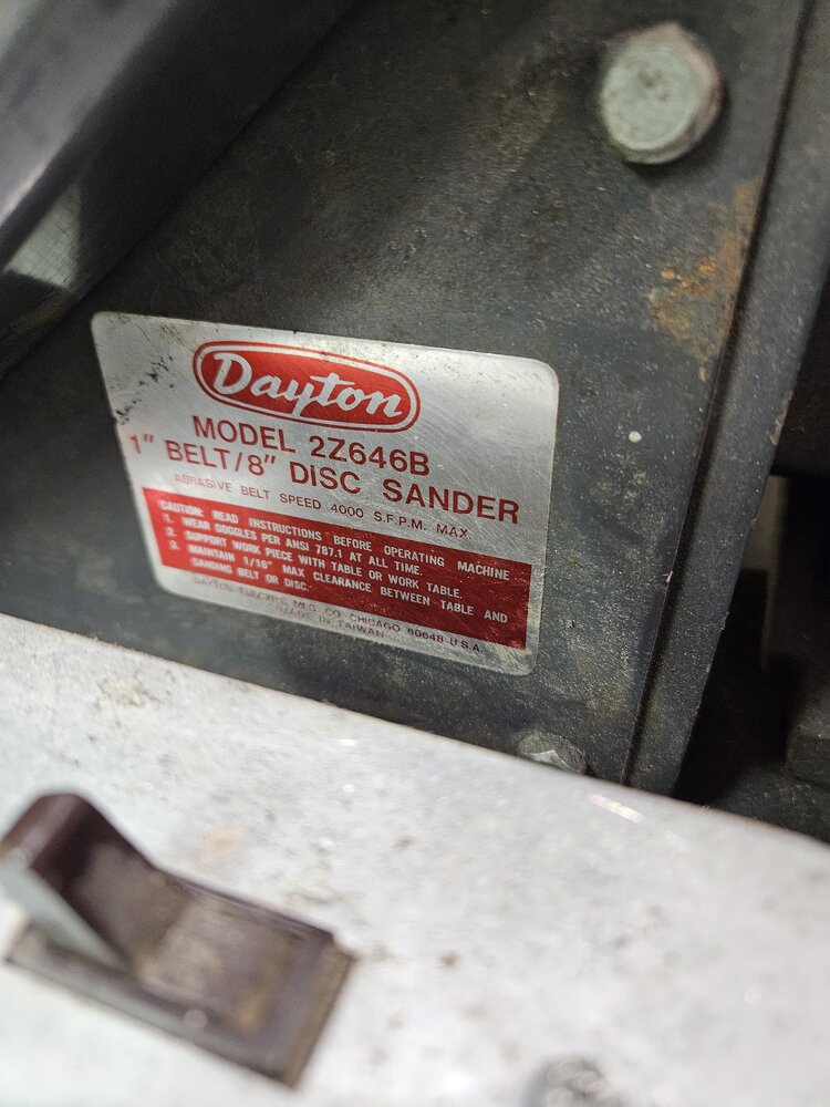

Well, i just bought a small one off marketplace. We'll see if it helps me any, lol.
do share the results and feedback on said unit! I've been eyeballing some, need some motivation to spend
Played around some this evening before dinner.
I don't have a sanding disc for the sander yet, but took a few pieces to work to square up for practice.

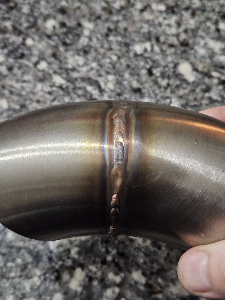

I was struggling two days ago when i started. I had too small of a gas cup, and honestly, i think that was most of the problem. Having no gap really made it awesome though.
The Solar Flux actually left a shiny weld on the inside. I know it's much better than if i didn't do anything.
and i still suck at tig.
