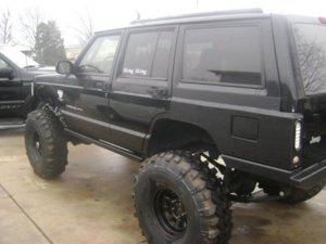

Well I quickly realized how flimsy XJ body is and i dont want to end up with a recked XJ in the first few months.
i want fender protection and sliders
i mocked up a little something that i think would look nice on my computer. the grey that stands out would be were i think some tubing and square dom would look good and serve a lot of protection
what ya think?
Have you seen anything where i could buy it pre made or is custom going ot be cheaper?
I still dont have any welding capabilities....sorry charlie
I think ya just need rockrails to save the unibody, keep the doorframes square so the doors will always function. Leave the fenders open, sacrificial offerings to the rock gods.
Start with some rock sliders for the rocker panels, Depending on how far your tire stick out from the fender wells, But mine in a TJ keep my fenders in pretty good shape. Tires hit before fenders, Unless I am really off camber.
Like these
I cannot recommend AJ's offroad Super Rails highly enough for your XJ. I know you haven't wheeled with me, but ask just about anyone here I beat the everliving caca out of my sliders. I have the AJ's Super Square Rails and I absolutely love them. I've smacked the jeep side to side on rocks with them and they've barely dinged. They're bolt ons and also bolt to the pinch weld. The tube rails are just as strong.

x2 on AJs. I have the tube version on my white classic, looks identical to the pic above. I've been fairly conservative with mine, since its a DD, but I don't hesitate to pivot the entire Jeep on them, or drag them up the ledge before RML @URE.
