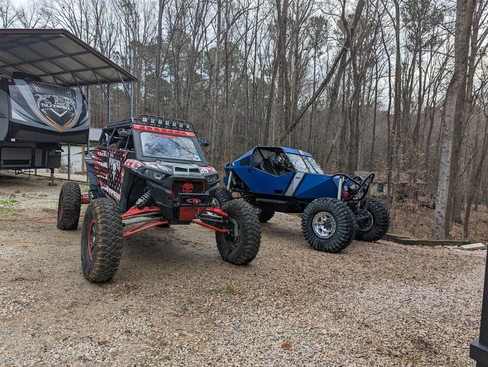

Nope, never thought I'd do tis, I bought a razor. Nothing fancy, just a RZR 800. So I am in the dark about these things. It's plain, and I need some BUDGET friendly accessories, like:
Mirrors
Some storage on the back, that doesn't involve and ratchet straps or bungee cords.
Ideas on an Ash tray. Yes, I smoke, but it's difficult to put a cigg out and a place, other than the floor, to put the butts in.( I do not throw any part f a Cigg on the ground, that belongs to someone else.
It has 4 LED light pods on top, all 4 have it's own switch, Any idea why it would be wired like that?
Also, after taking my first ride to day, and Cherry Crush adventure park (only like 17 miles from my home), A lot of times, well, most of the time, it wants to grind when switching from hi to low, low to hi, and mostly switching from and forward gear to reverse. Any thoughts?, Most times to change gears, I had to shut it off, and then shift into desired position.

Amazon had some decent mirrors I used on my jeep. As far as an ashtray what about the cupholder style and a cage mount cup holder?
The grinding probably means the shift cable needs to be adjusted...OR...the secondary is still spinning. I'd put money on the second one since you said it shifts fine when you cut it off.
I'd start with disassembly and a good cleaning of both clutches. If it has any amount of miles on it and they were never cleaned, the one way bearing in the primary is likely due for a replacement or a cleaning and regreasing. Pull the cover and start it. If the rear clutch is spinning in park or neutral and it takes any amount of heavy force to make it stop, there's your culprit. It can also be a belt and/or shaft alignment issue. Sounds daunting, but it's easy once you dig in to it and do it once or twice.
You'll wind up needing to buy some tools as well. A primary puller, belt removal tool, and maybe an alignment fixture.
I picked up some pretty inexpensive side mirrors and a rear view from HighLifter. Falcon Ridge is the brand, I think. They were on sale and they work pretty well. No complaints! I didn't need anything super fancy, just functional.
SuperATV is also a good place to find things. Mother Clutcher has solid and affordable clutches if yours are too badly worn. I had to replace both of mine.
Milwaukee Pack-outs seem to be the go to for all the SxS folks nowadays. I’d hit up Amazon or HF for the cheaper versions of stackable storage.
I have the pullers for a Polaris RZR 800. You can have them. PM me your address and I’ll mail em to you.

for reference, it has 3000 miles, and 300 hours on it. And, the shift cable was new on it. So, could very well be the clutch assembly!
Well, in that case, I'd definitely make sure the cable is adjusted properly! It probably is and got replaced because they assumed it was that and they never considered looking at the clutches. Lots of things sliding around in there and they're often neglected.
