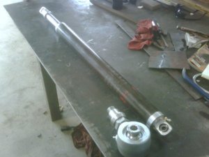

About 2 months ago a guy came in my shop, introduced himself and had a few questions about a rig he was building for himself. After talking for a while we got to talking about some fox and bighorn air shocks I had for projects. He told me that he had been building race car and truck shocks for I think 14 years and seemed very knowlegable about shocks in general. While he was looking over the shocks I had laying around he said he thought it would be neat to make some and start selling them because they were a very simple design and he felt he could improve on them.
Then a week or so later he stoped back by and said he had just ordered enough materials to make a few prototypes and would be in touch with me when they were finished. Then yesterday he brought me this

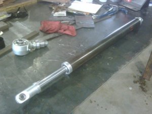

This is one he brought to show me how it was going. The exterior of the body has not been machined yet so it is a rough prototype. It is more than just a simple emulsion shock it has an internal reservoir in the top of the shock body with a floating piston. Im hoping he will join this site soon so he can explain more about it but a few things he will be able to incorporate in the shock is a hydraulic compression bump to eliminate the need for running bump stops. The body can also be threaded for coilover springs. I'd love to have some input from some of you on what can maybe be done to make it nice.

Well a simple Ori strut is kinda what Im hoping it'll be. Eliminating the need for bump stops is a big plus in my mind thats another couple hundred you wont have to spend per corner. As far as pricing goes I dont think he's to that stage yet but when he is I'll let you know. My understanding is that he's building them to be low priced and functional. So we'll see.
Im building myself a Sammi project and I'll be running them on it. I hope to have it going by early january so maybe you'll get to see the finished product if he hasn't already sold some by then

What is the travel on the one you posted? Does the reservoir being in the top of the shock make it considerably longer?

17" travel and I think the reservoir adds 2 or 3 inches to the body. Just under 4ft fully extended. Kinda long but looks cool hangin out the top of the hood :D
