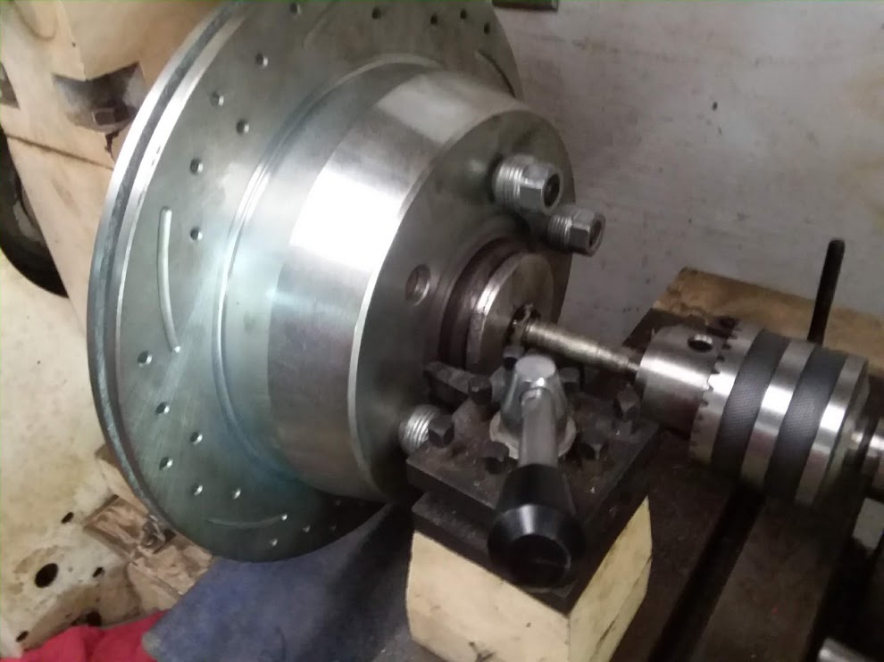

Just posting up, some picture i took during the summer....
This for my jeep, rear axle so i can run disk brakes.... (Toyota rear)
This one is i mount a wheel 'hub' off of a newer vehicle, the bearing were not moving when i took it apart, which is why i wanted it....
[Thanks for send me one (i forgot your name, the stoke is bad when it come to that :( please send me your name, again :( ]
Anyway... i am not a machinist by any means, i hack thing together and stuff.... ;)
Hub in the jaws, bolt on rotor, secure with lug nuts, aluminum from my bearing install kit, follow by a bolt with an angle cut on the end (oil it up)..
All comes up the center within .003.. not bad....
This is about the most that i will turn in my lathe....
Its slow, but it works.... :flipoff2:
