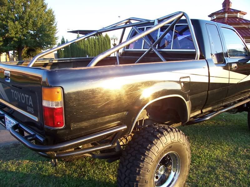

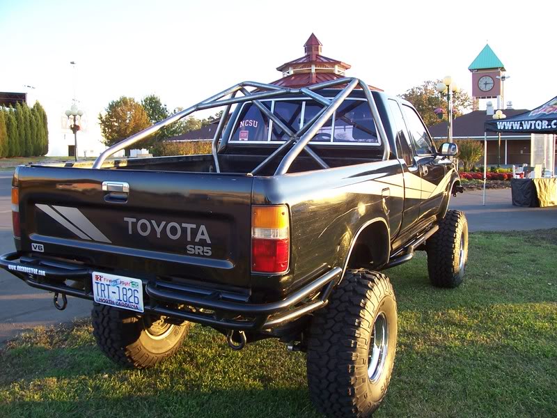

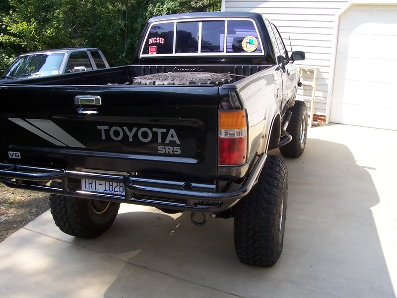

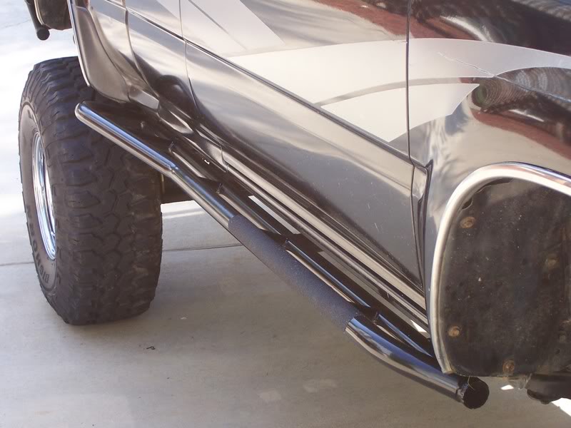

UPDATED 10-24 Here are a few Shots of our new Bumper and Sliders~~~:driver: -----OH

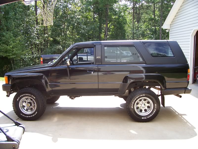

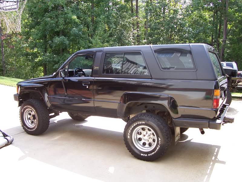

and a few Pics of our newest Ride--- another RUNNER ( soon to be SAS)
Sliders
I am sure most of You have Fig. it out that Michael ( Rockdustfab) Built the Sliders and Rear Bumper, ILL have to say VERY Impressed with the Young MAN---------It Turned out he just lives right down the road from me,so Ull be seeing More Of his Work on the Truck
Thanks David
PS---- Michael---Do I get a Discount next time for this Post? :driver:
Damn, dude, those are some sweet 'yotas! Did you make the sliders pop out in the rear of the truck so you could stand on them if need be?
the purpose of the kicker just before the rear tire is to keep the wheel from hitting and obstacle head on, it'll keep the back of the truck away from the obstacle more. I don't know why more people don't do this on a full bodied rig.

Michael - Nice design on the rear bumper..
Might want to mount the license plate in front of the bumper though, popo could hassle you for it.
x2 on the rear bumper REAL nice Michael!

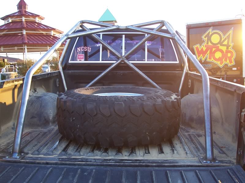

Different design on the hoop bar yes, but that was the point. The truck is getting an exo eventually, and the same shape will be used on the halo bar I hope (if he want's to). Once the exo is done, there will be no issues with the center being lower than the outer edges, not that I see it being a huge issue right now. Either way if it rolls it is going to get crushed down to the bar anyways.
