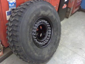

Me and Andy went in together and got a set of the 24 bolt H1s and the MT/Rs. He got the tires and I got the wheels and his old tires. So here are some pics.

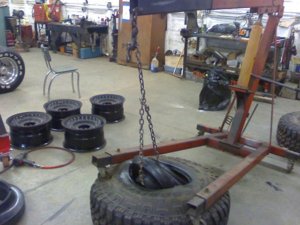

Here we are pulling out the one piece rubber run-flats....
attachment.php

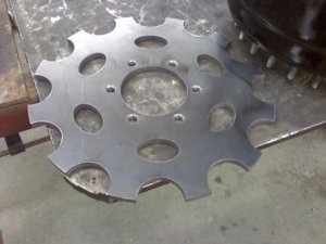

and here are the MUDPRO wheel centers (thanks scott)...
attachment.php
and here they are welded in the back half of the wheels at 3" back spacing:smokin:...
attachment.php

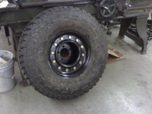

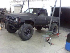

Got them mounted up and put on...
attachment.php
attachment.php
attachment.php

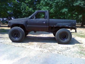

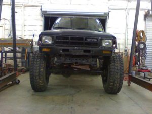

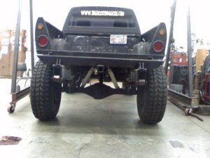

More...
attachment.php
attachment.php
attachment.php
Here is the before pic....
attachment.php
It is amazing how much a set of tires and wheels can change the whole look of a truck.:driver:

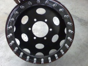

We got Andy's mounted tonight. We knocked out the studs and put 5/8 bolts in them so he don't have to worry about them with no rock ring, we also moved the valve stem to the back side of the front half so it wont get ripped out. Here is some pics....
Andy lubing up the bead....
attachment.php
Done....
attachment.php

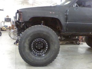

I'll try to get some pics of them on the XJ.
