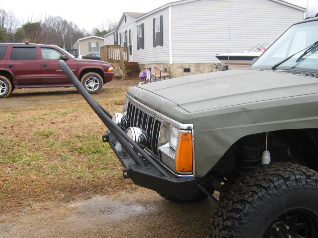

Guy on the baord made it, I would say he added the stinger. Looks great.
Why did you put the stinger on?
If it's for looks then I have no comment.
If its for function, then not going to help in an end over roll over situation. It would just fold into the hood. A usefull stinger has braces going toward the windshield. If you do a smaller one then maybe it might help some with just having the side braces.
