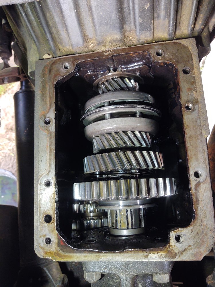

Yep, I'm taking the transmission apart today.
In for what you find. What is chatter?
I found more or less nothing. I just drained the old GL5 and dumped in a gallon of 75-90 full syn. Took it for a 30 mile test drive. Seems way better.
I think it's just inherent in how they're designed and assembled. They're a truck transmission after all. Basically industrial. Not super refined. Just heavy and strong!
