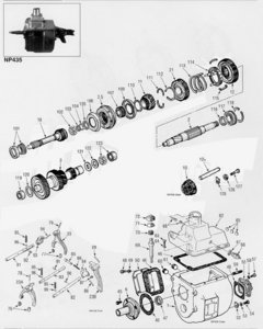

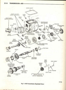

psst... i went to google and typed in 'np435 diagram'
#2 link had these pics... have fun
and to add some basic manual tranny tech... If you start with removing the front, bearing retainer and any rear retainers or bearing clips. The main shaft should almost be ready to lift/slide out...
