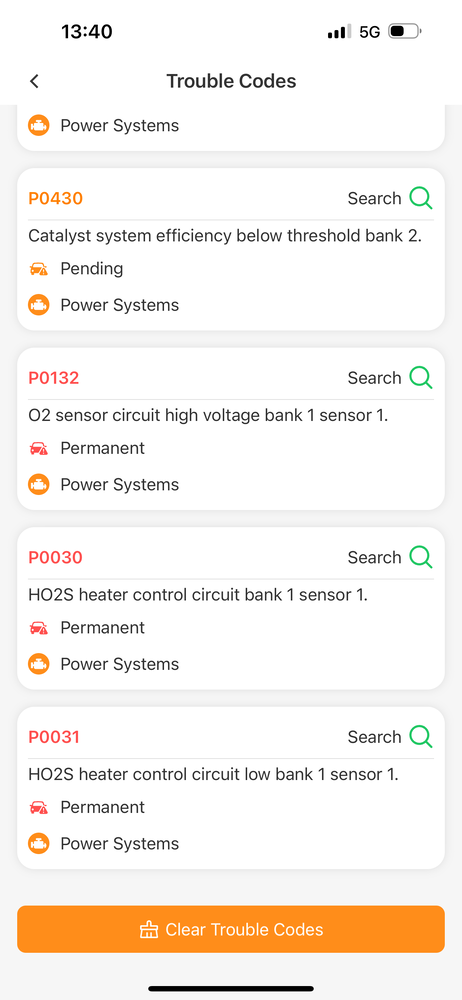

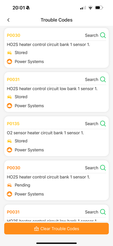

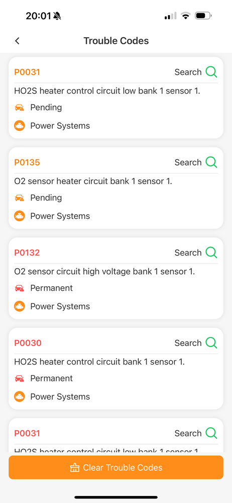

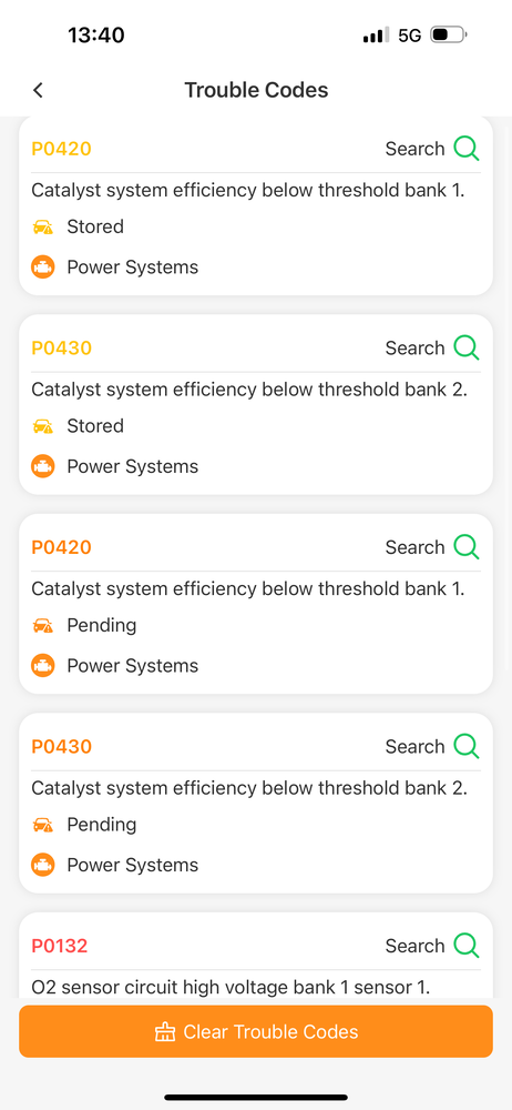

FFWD to the other day and the light is on again. I ordered one of those Bluetooth OBD2 scanners and it’s reading the following:
It’s all bank 1 sensor 1.
What’s the chances I have a bad new sensor? What’s the chances it’s something else?

With the code going from low voltage to high voltage on the heater circuit, it sorta makes me lean towards that sensor itself having a bad heating element.
Checked all fuses on all three panels. Under hood, and on end of dash in door jam on both sides. I only know of those three, if there’s more. All fuses have me a continuity beep or passed visual inspection. Guess it’s O2 replacement time.
