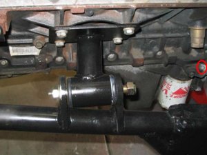

Here is what Mike from FOA told me.
LS 1, I think is the same as an LS2 which I have and I attached it to the port in the back of the intake manifold where the oil comes out to the oil pressure switch. I took mine off and taped it to 1/2 NPT but it is fine with 3/8" NPT ............
Bottom line you can hook it up where ever you want as long as it is High Pressure, The oil pressure lines generally will not work. If you have any doubt you need to check the pressure before you hook it up.
Drill out this hole and tap it. It is on the pressure side of the oil system
