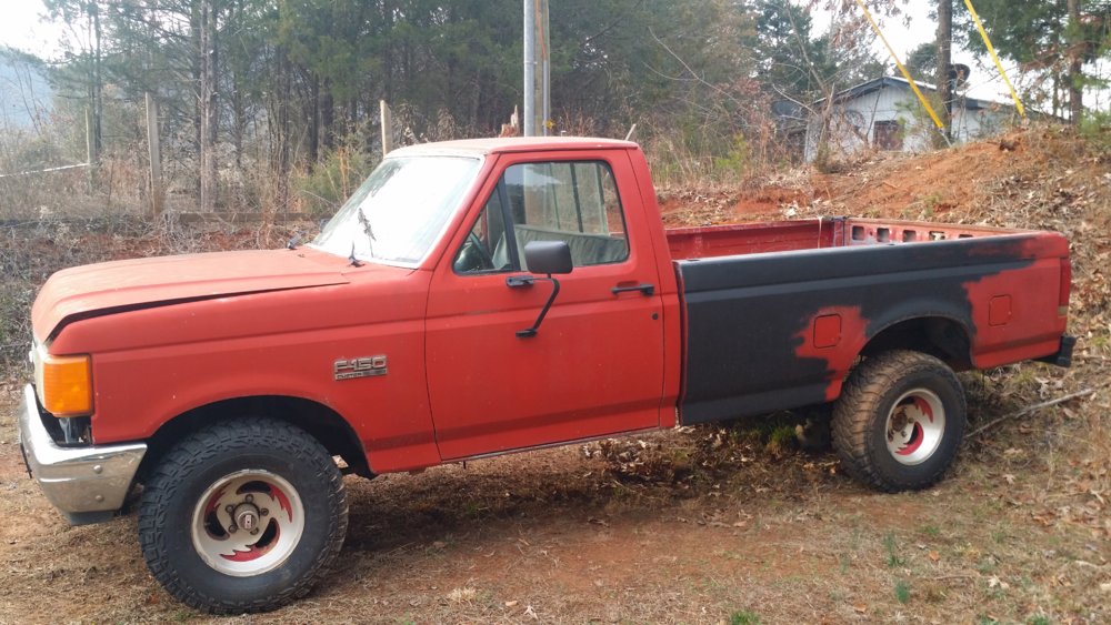

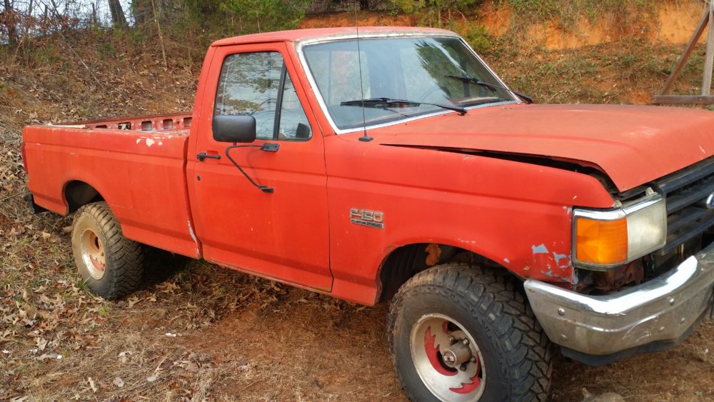

Recently purchased a 1987 F-150 4WD. 300(4.9) 6 cylinder, T-18. Dual tanks, long wheelbase
Issues:
Needs a clutch, PO said it was slipping when pulling in high gear

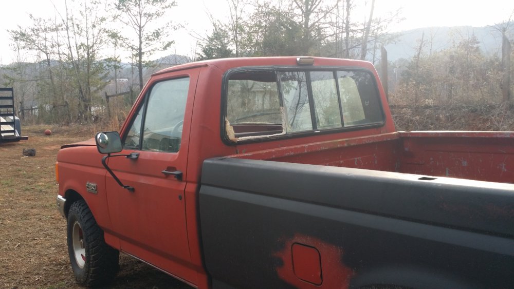

Sliding glass in rear of cab, stationary piece busted out behing drivers head area taken out by a weed eater
seat in poor condition
no carpet, just bare metal floor. Some rust in floor at door
slightly bent bumper

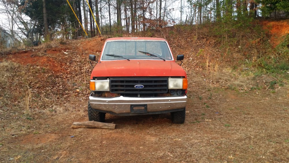

Piece(not sure what it's called) between bumper and grill missing
has two different headlights
needs a new tailgate or the rods to fix it.
Horn doesn't work
Needs valve cover gasket
Has small draw on battery
The truck was originally a farm truck, from a working farm that did tours for groups, mostly for kids
It was purchased and used as a DD until parked, 2 years ago.
Would not jump off, battery was completely gone. Bought a battery, started right up. Stunk like rotten eggs due to the old gas.

The glass behind my head on rear sliding glass window was busted out by PO with a weed-eater mishap,
now has a new plexiglass replacement(I figure some stickers will keep it from being scratched, and give me more HP
