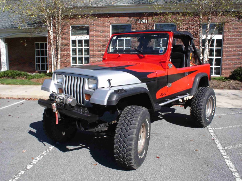

As you can see from the final pictures, the paint job came out looking sharp and I have received lots of compliments from fellow jeepers, especially those who saw the rig in the 3 tone camouflage/rust/Islander blue days! If you get up close and look at the paint, you will find flaws, such as my runs, but from five feet out the rig looks really nice.
We finished the paint job up back in October and I have wheeled it several times since then and the paint is still holding up well. In my Crackers Neck article here at Off-Road.com you will see that the trails are covered with lots of Laurel and I have a fresh set of “brush marks” down the hood and both sides of the Jeep. Since we did not use a clear coat over the paint, I can simply polish (not wax, but polish which is slightly grittier), the paint and the marks will fade or disappear entirely!
For me, this is the perfect paint job, we have less than $80 in materials (see below), and the process is simple enough that even I can do it! At some point in my hobby, I fully expect to flop the Jeep and I can repaint the entire side again for less than $40! The paint photographs well for the POSER shots on the trail and is tough enough to stand up to brush striping and other abuse as well. My right rear corner now has a large 8” dent below the tail light thanks to a tree limb at “the Waterfall” (Welder, Callalantee article) but the paint did not break or flake off.
I know we are not supposed to be worried about how our trail rig looks, since we are “hard core wheelers”, but maybe you are just interested in preventing further rust, or you are just getting tired of being “another Red Jeep?!?” I wanted to stand out and have the added benefit of my wife actually willing to ride in the BUG, now that it isn’t rust and camouflage any longer! (Big Unique Geep now?)

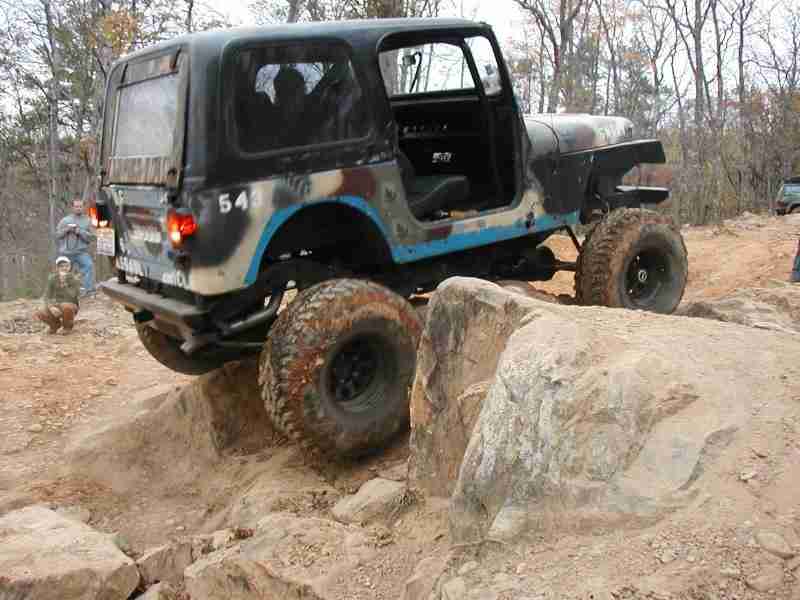

Before, during and after
