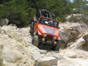

i like the way that orange looks, do you have any pictures closer up to get a better look at it? does the tsc paint advise you to mix the paint for a better spray?
I'll see what I can dredge up.
It has faded a bit in the three years since it was painted, but I still have 2/3 of a gallon left, so I can spray it again.:driver:

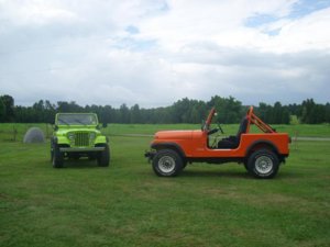

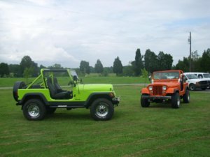

beach 061.jpgA back yard paint job is what you make it. I have did my share of them. Like others have said stay with a single stage paint and prep,prep,prep. The prep is what makes a paint job. I painted both the CJs we have now. The green one is auto paint and the orange one is tractor supply Kubota orange. They are not show paint jobs but they are good enough for drivers.
the orange and green looks great, i'm thinking about a competition orange color with the black renegade decals
that would be nice. the orange one is a renegade but I have not got the decals
