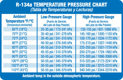

I believe with ambient temp being that high your pressure on the low side should be like 45-55 if I remember the chart correctly, but if it quit taking it I’m not sure.
150 isnt high enough with that ambient temp. Need more freon to get cold temps.
Look at the pressure chart for 134a. Probably still need two more cans.
