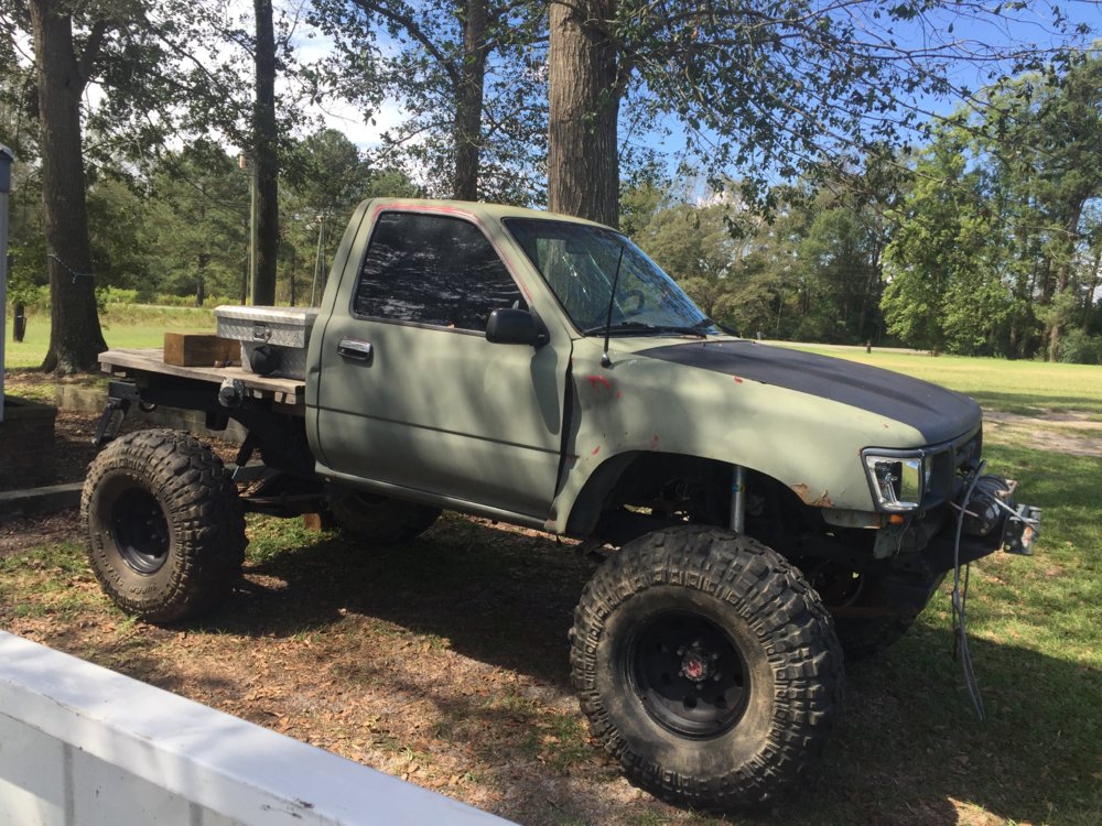

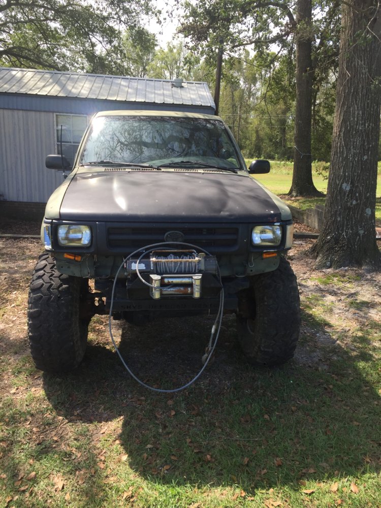

The truck is a 1993 with 22re, 5 speed, single stock case. 5.29s in the axles. 63" chevy rear springs, 5" trailgear front springs, high steer, bobbed maybe 6". It has a rotten flatbed, cracked windshield, some goofy long rear shackles, and was on bald 38.5 GROUND HAWGS when I bought it. :) I couldn't sleep knowing people might hear that I had a truck on ground hawgs, so I snagged a set of 36x12.5x15 TSL sx from @92_beater.

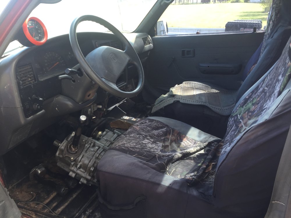

First order of business is to get the drivetrain functional again. I picked up a used w56b, which uses a topshift case, from @kyleg336, but have been catching hell trying to track down a 6 bolt shifter to use with this trans. Unless, someone chimes in that has one, I might be a looking for another w56 that uses a forward shift case.

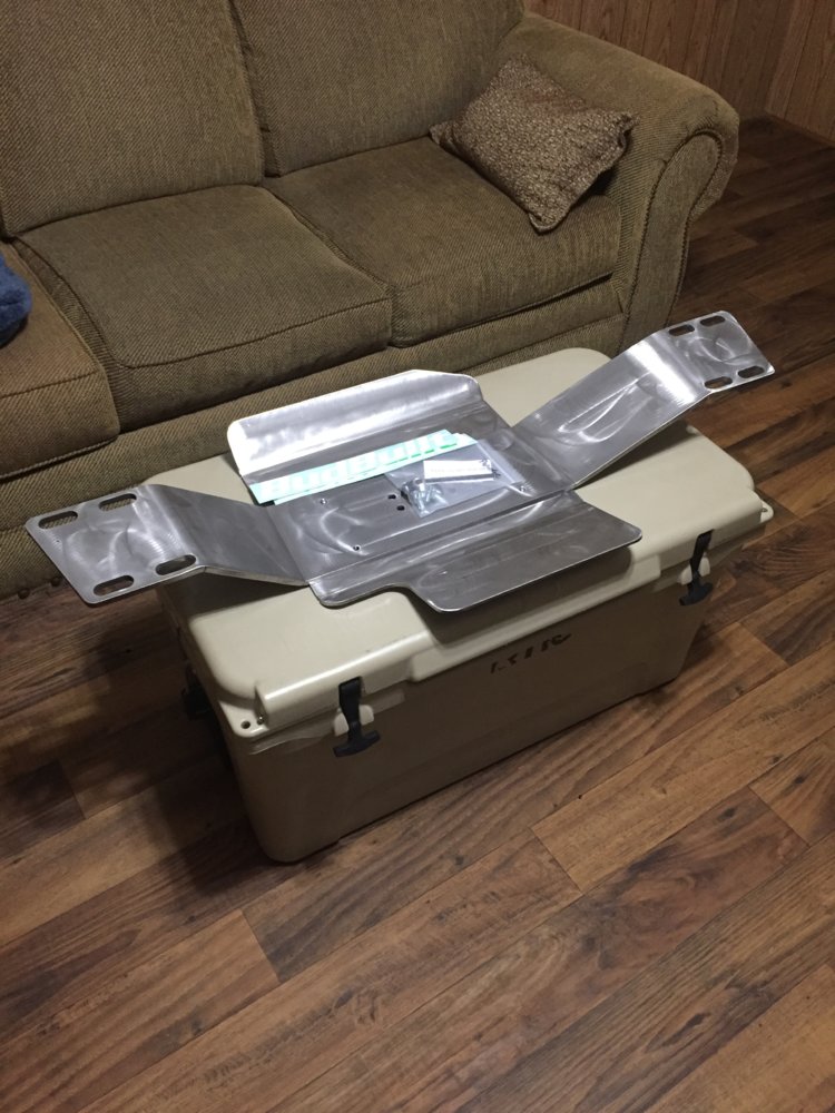

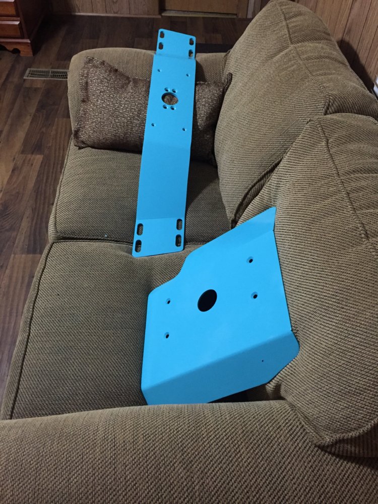

I placed an order for a single case BudBuilt crossmember and am eagerly awaiting its arrival so I have less reasons to procrastinate making this truck move on its own. I have a 21 spline 4.7 case to use with this truck.

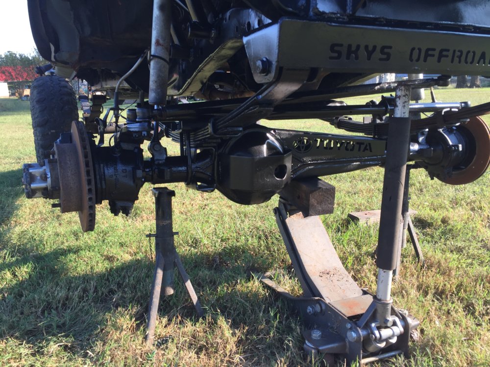

If its not already, box in that front sky hanger before it gets bent up. I did mine after I saw one bent to crap.
That's a good idea. I saw that it wasn't boxed the other day when I was under the truck painting. I've been waiting on my shipment from Rockauto to show up, with my new clutch, pan gasket, rear main seals. I found a w56a/b six bolt shifter from a Toyota hoarder out of Candler, 65$ later.

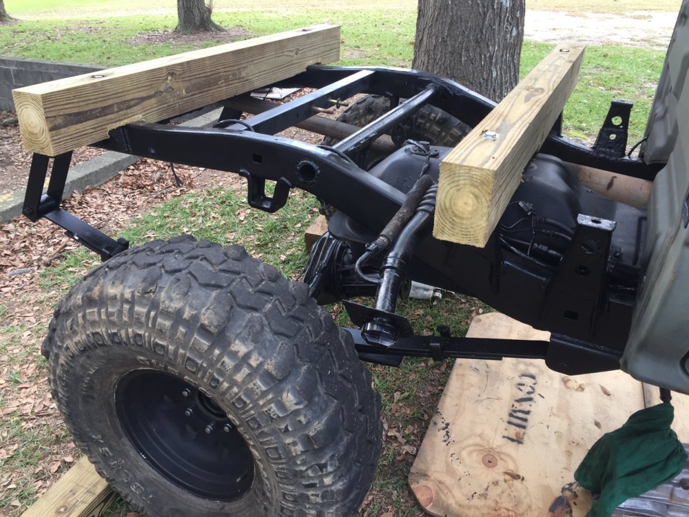

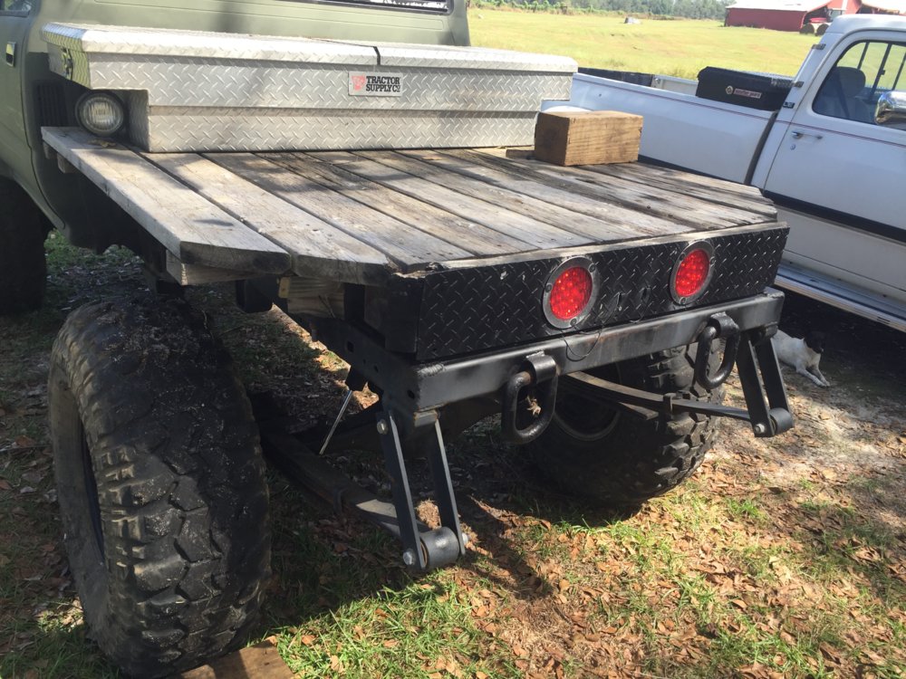

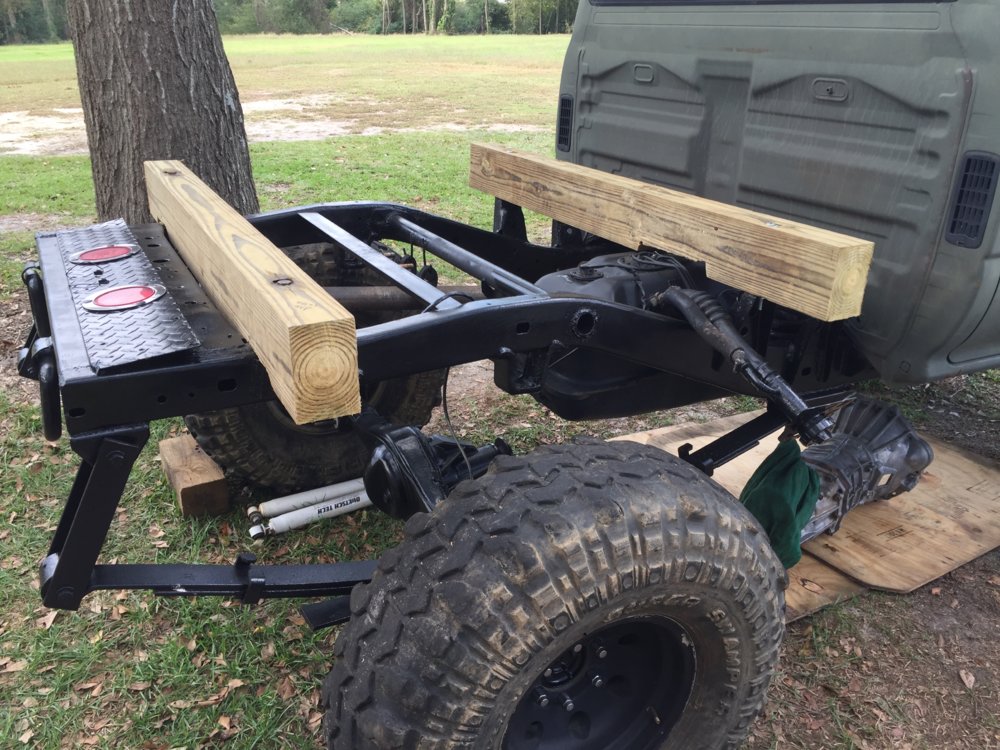

I actually really liked the wooden flatbed that was on the truck when I bought it, so I'm recreating it with decent materials and hackfab woodworking. Today, I got the 4x6 runners fitted and bolted down. Counter sunk the bolts with impact for that extra touch of class.

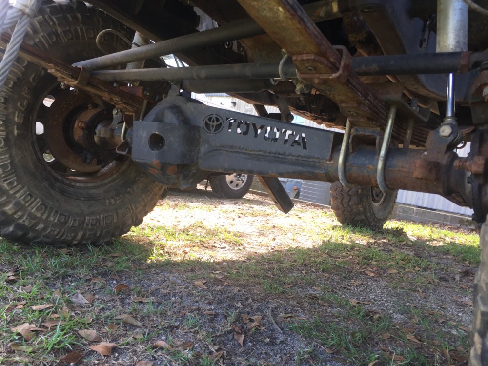

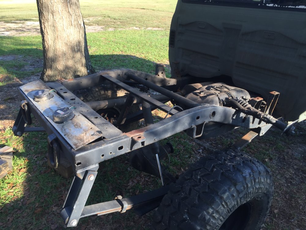

If I chop those rear shackles down an inch or two, what sort of axle wrap issues would you expect?
It’s my opinion that axle wrap is more dependent on the spring pack. How many leaves are removed? How soft are they?
Just drill them and leave them long for "mock up" to see how they look. If you like it chop them off if not move it back and weld up the drilled holes or run another bolt and spacer to fill the void. I'll see if I can find a pic of how I did my front hanger.

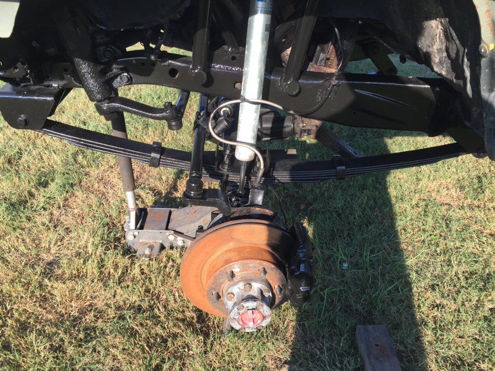

I just checked those shackles are 9" center to center. They are 4 leaf 63" chevys. I'm thinking they used the long shackle to compensate for having moved the rear shackle mounts forward. I'd like to drop it about 2" in the rear.

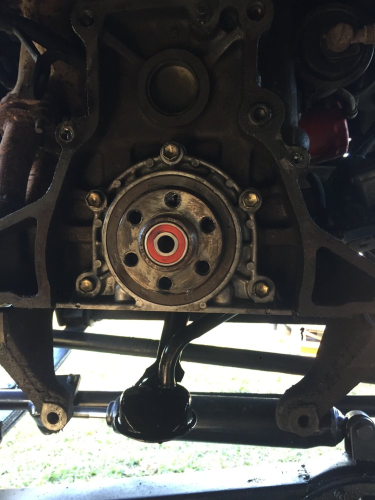

Had planned on having the transmission back in the truck today, but went hunting and got a late start. I also had planned on swapping in a fancypants aluminum oil pan that came of a parts truck with a 20r. Didn't do the research before I pulled the stock pan, and realized that you also have to use the 20r oil pickup tube as well.
So I replaced the pan gasket, slapped the stock pan on there, replaced the rear main seal which likely did more harm than good, and bolted up a new 9-5/16" Exedy clutch. Stock clutch for the w56a is 8-7/8. I've run the 9-5/16" clutches in a w56c before with no issues. I did manage to hose myself in the eye with brake cleaner richochet one good time.
