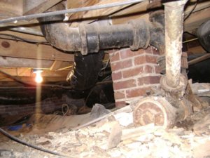

Thanks guys. Just a few minutes ago, I had the great fawking pleasure of crawling under the house to clear a clog. So I got some photos while I was there.
Here's where I'll insert a wye with the new 2" line. The wye in the background is 1-1/2" and is cobbled together beyond belief. It will all be abandoned when the new stuff goes in.

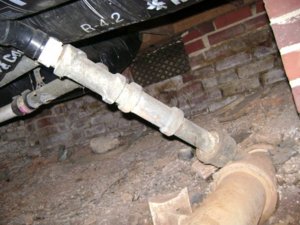

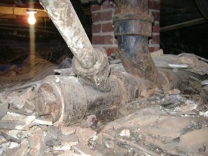

And here are two shots of the cleanout at the other end of the house.
