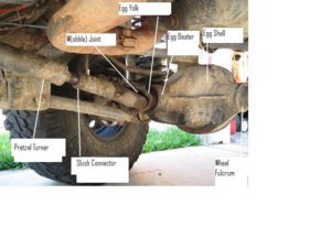

For reference, I labeled a picture (though it's a front axle). Which part is broken?

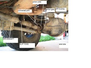

It's like a murder mystery.
I'm going with Capt Peacock in the Library with a Candlestick. What did I win?

The spindel gear you refer to, could you mean the male side of the slip yoke?

2)Yes I was talking about the male side of slip yoke when I said spindel gear(still learning)
