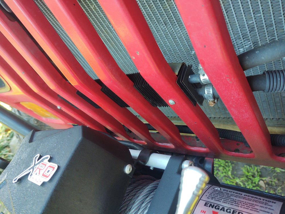

I hated the idea of mounting a cooler to a $300 radiator so I drilled holes and ran small stainless thru bolts into my grille (they're like 100 bucks 😂)
