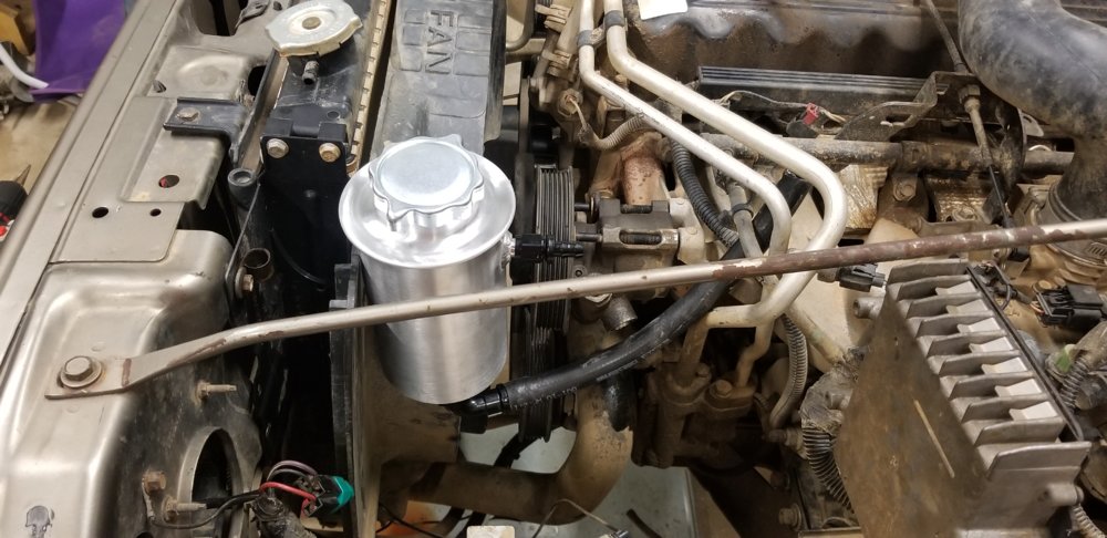

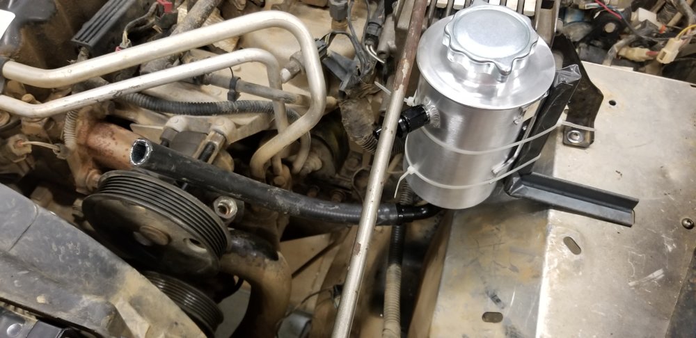

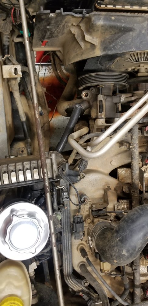

Never having done this and only having a minor in keyboard warrior knowledge, I'm looking for some opinions on where to mount my power steering resi. Have 3 options that make sense. Rig is a TJ with douche fenders(Metal Cloak's) so there's plenty of flat surface to mount to.
Option 1: doesn't really require me to move anything.
Option 2: will more than likely have to ditch the washer fluid resi
Option 3: will have to relocate the coolant overflow. However it's the shortest run to the pump.

Must be nice to have so many options . My vote is for #2 since it looks like it's in line with the inlet.
