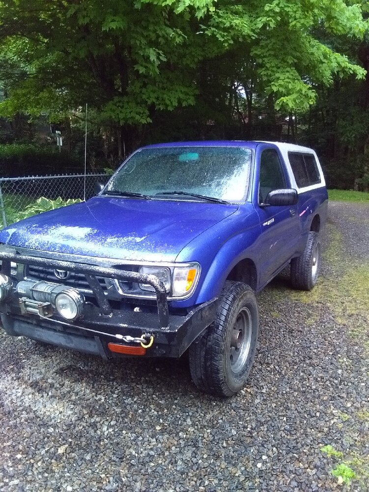

I’m sure this has been covered so link other threads if you know of ‘em, but thought I’d see if I could pick y’all’s brains about keeping the underside of my truck from rusting. Just picked up a 95 Taco, body is ok, the frame and running gear look as good as I’ve seen (why I bought the truck), but a lot of the other Yotas I looked at were pretty far gone. What’s the best way I can keep mine from looking like the others? Looking for cheap DIY in the driveway kinds of solutions that are worth the effort, not looking to spend $20k and have the frame blasted/coated.
