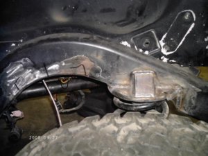

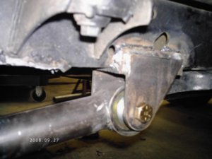

91oneton Well-Known Member Joined Sep 10, 2005 Location conover nc Sep 27, 2008 #1 first i didnt do the fender trimming .. just wanted to clear the air on that anyways the owner brought me a d44 hd and a d60. i started my cutting the old coil buckets off and cleaning the frame and moving them back 10 inches Attachments new buggy 078.jpg 48.1 KB · Views: 624

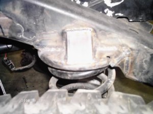

91oneton Well-Known Member Joined Sep 10, 2005 Location conover nc Sep 27, 2008 #2 one more frame shot the center black line is where the buckets use to be Attachments new buggy.jpg 61.4 KB · Views: 648

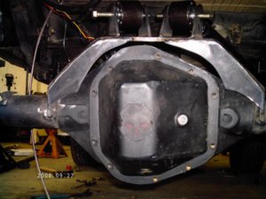

91oneton Well-Known Member Joined Sep 10, 2005 Location conover nc Sep 27, 2008 #3 home made axle truss.. 3/8 by 5" plate the braced the back with som 1/4 Attachments new buggy 083.jpg 62.3 KB · Views: 596
91oneton Well-Known Member Joined Sep 10, 2005 Location conover nc Sep 27, 2008 #4 truss Attachments new buggy 084.jpg 58.5 KB · Views: 638

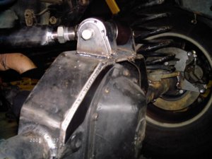

91oneton Well-Known Member Joined Sep 10, 2005 Location conover nc Sep 27, 2008 #5 the large ballistic joints are 3.5 " across so i welded some 3" channel to the frame then the brackets to that Attachments new buggy 079.jpg 41.7 KB · Views: 600

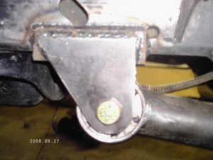

91oneton Well-Known Member Joined Sep 10, 2005 Location conover nc Sep 27, 2008 #6 another Attachments new buggy 085.jpg 43.2 KB · Views: 588

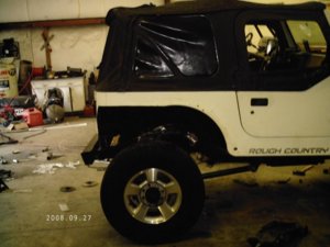

91oneton Well-Known Member Joined Sep 10, 2005 Location conover nc Sep 27, 2008 #7 and its back on its tires rear is done all but shocks Attachments new buggy 086.jpg 50.7 KB · Views: 585
91oneton Well-Known Member Joined Sep 10, 2005 Location conover nc Sep 27, 2008 #8 thats ride height with some 35's and my dodge wheels. i think hes gonna run 38 tsl's and this is his daily driver Attachments new buggy 087.jpg 41.7 KB · Views: 576
