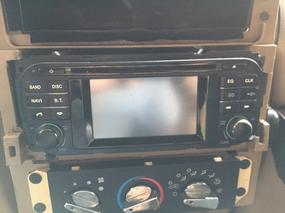

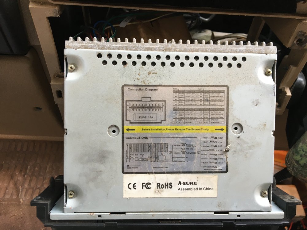

He has boxes in the back some have parts. Almost an entire OBA system minus the compressor. First thing I want to get right is the radio. Yea I know but that was something he and I worked on before he moved to Arizona a couple years ago. He moved back about a year ago. It’s got a Chrysler logo when it comes on. Might be from a JK. Looks like he did some cutting on the TJ plastics.
Any thoughts on what to search for?
Sorry for your loss. The radio deal might be some ain’t thief device, I know GM has it if you remove the radio you have to hook a scanner up and reflash the computer or some shit like that

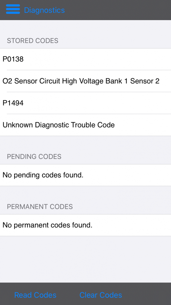

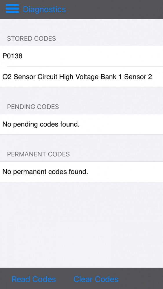

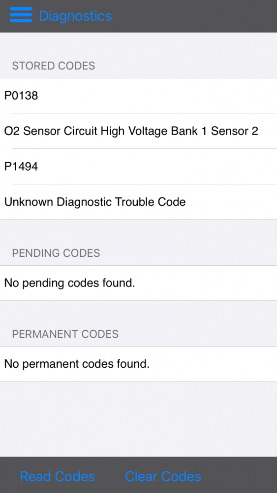

Actually it does not. The check engine light was off all the way to Hartsville. Sent my son to the store and it came back on. He was thinking it might be an exhaust restriction. Like a clogged cat. It handles fine but it's boggy.
So an update.

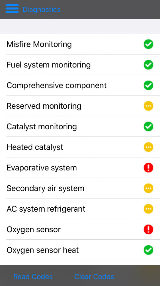

CEL showed back up. Talked to the @Jody Treadway O2 sensor ordered. She cam alive this afternoon. We are thinking the gas’s sitting may have cased the boggy ness. We shall see.

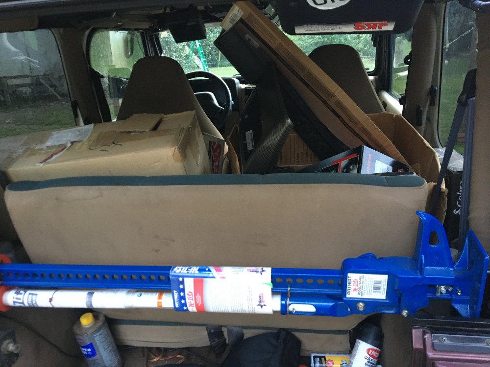

Ok, rear shocks are ordered. Fronts are on national back order. Called 3 different shock dealers and looked on 4 or 5 other sites. So this thing has the original factory shocks from 01. Anyone have some stock front shocks to get me by. Will be posting in the wanted section. This is what I need.
Install shocks this week man what a difference. The thump is gone. Replaced the O2 sensor and the code is still there and the other one came back. I found a vacuum port open on the intake and plugged it.

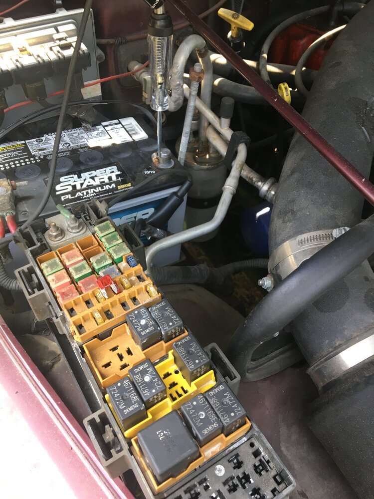

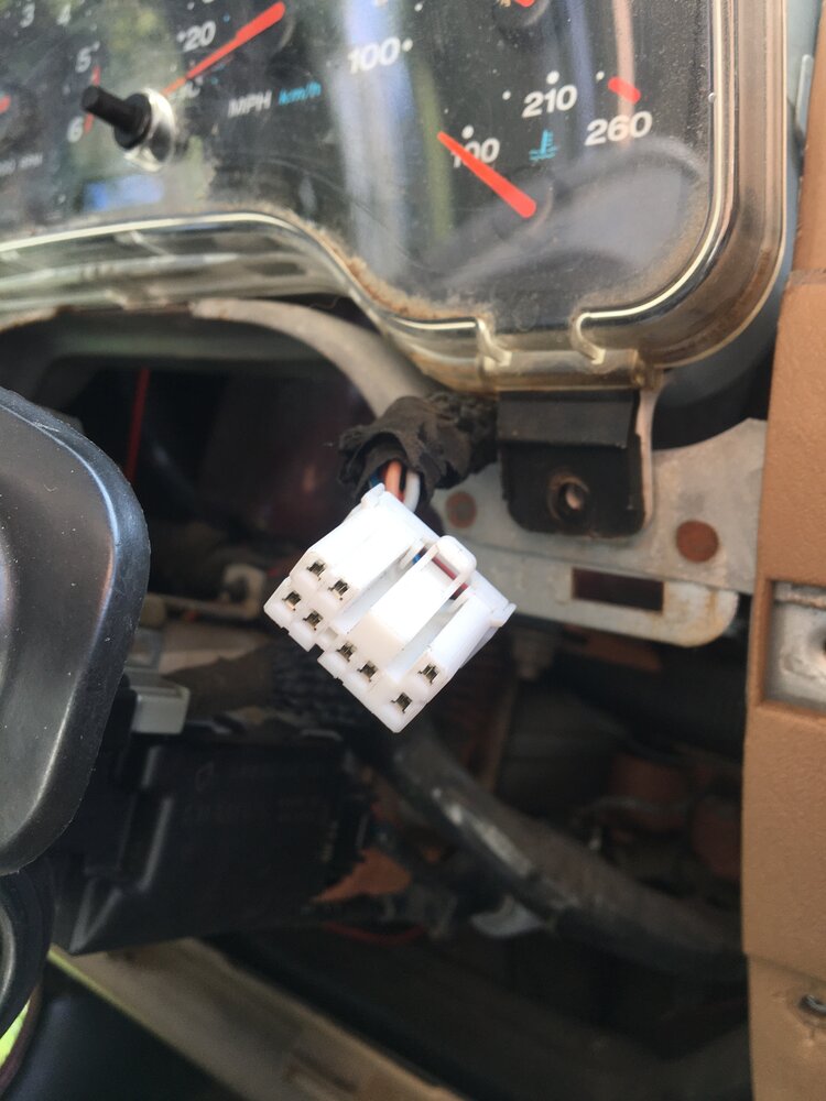

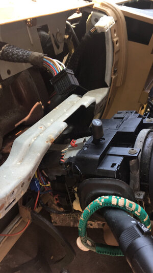

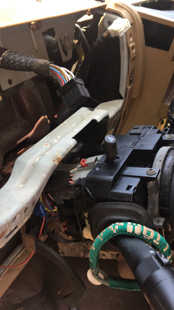

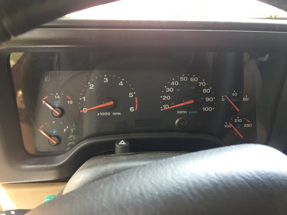

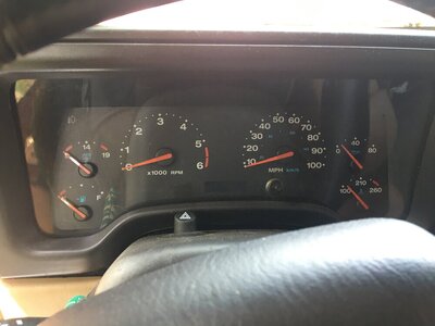

So I walked away for a bit. The battery has died a couple times and I knew I had a draw. So I finally got around to diagnosing the issue. Fuse 24. lead to instrument cluster and that lead to multifunction switch on the column. If I unplug the white plug on the back it started the hum from the column. Unplug the cluster and multifunction switch and it all stops. Switch plugged in and she hums. Plug the cluster in no switch and the light blinks. SO draw is in the wire between cluster and switch on column?

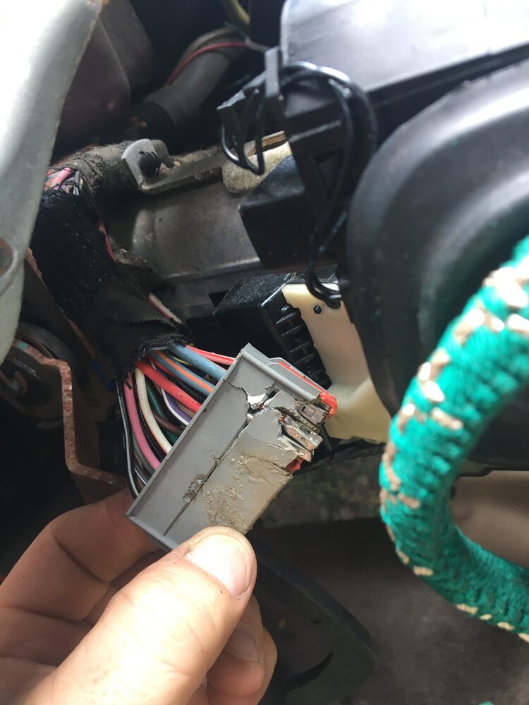

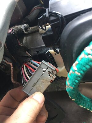

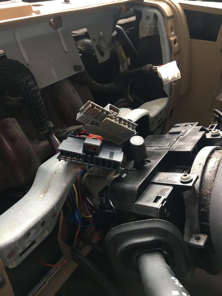

So after lunch I started testing. Plug is falling apart in my hand.
So I got a kit that came with wires. Also got a kit to remove the pins off Amazon. Replaced the crumbling connector and that didn’t fix it. So I replaced the multifunction switch.

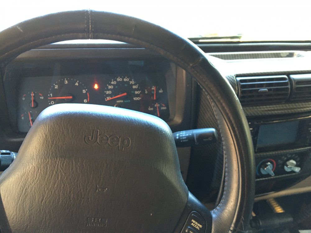

So that made the light get dimmer but not out. Connector was toast and looked melted from heat so I figured replacing the switch was worth the $40. Still pulses the oil pressure and temp gauges. Unplugging the white cluster connector makes it stop

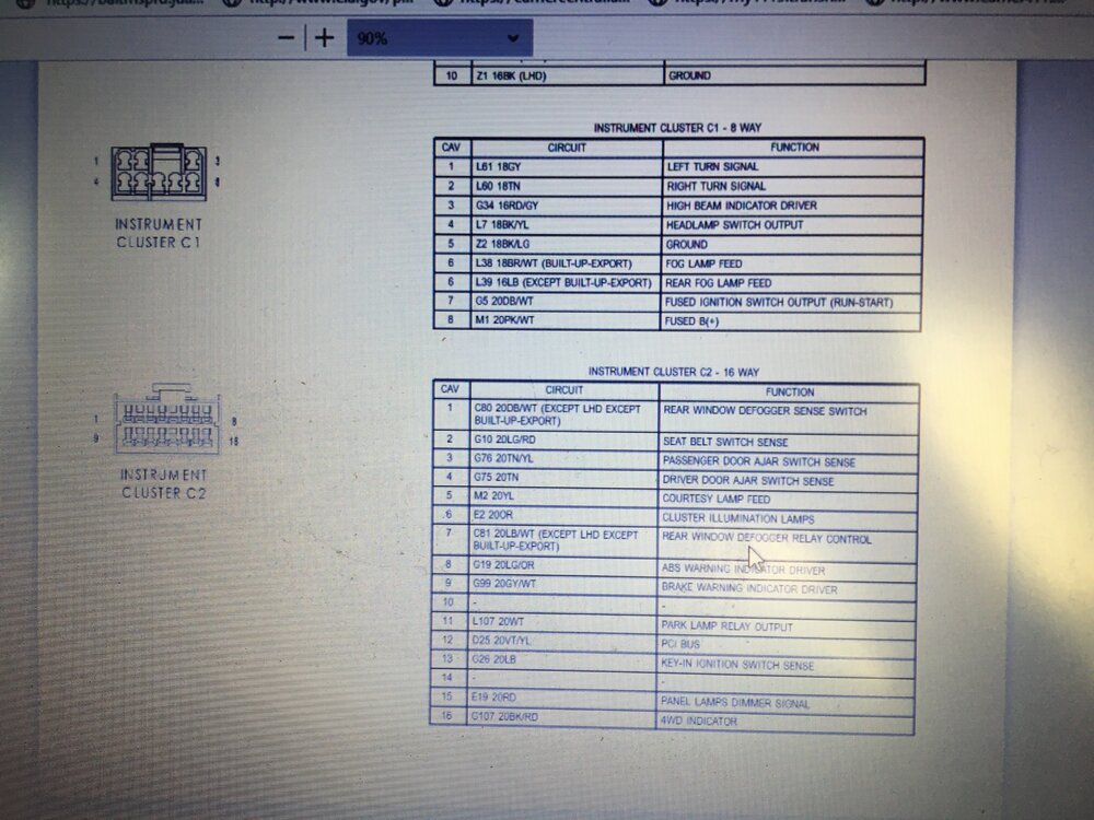

This I think is the correct pin out for it. None have voltage coming through them but 1-6 all test continuity to ground. Number 5 is the ground wire.
Any help here would be greatly appreciated.
Ok so back here again. Jeep is sitting because I'm stuck on this. It sounds like you have a key in the ignition but there is no key. I fixed the plug and it does the same. I will try messing with the ignition next I think.
Ignition unglugged and still does it. Unplugged the led tail lights and still does it. It actually sounds like the hazards are on. It's pulsing like they are but they are not. Unplugged the flasher relay and still goes. I did find that with LED tail lights it needs and LED relay. The front turn lights are not LED. Any thoughts on that maybe my problem? I keep thinking it's a wire somewhere in the dash or body harness. I'm stumped.

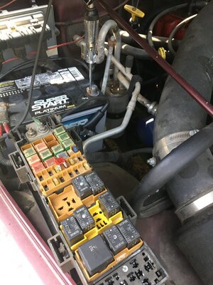

Battery voltage good? Grounds good and clean? No shitty aftermarket alarm? I would try a draw test with a test light, unplug random fuses 1 after another and see if you see a change, you could do it with a volt meter but I find it easier with a test light (if you don’t have 1 you can always make 1 with a old headlight)
That was done to narrow it down to where I am now. Talked to the @Jody Treadway briefly yesterday and unplugged the oil sending unit to see if the draw and pulse stopped. Nope. I'm back to this cluster or wiring or a faulty new multi-function switch.
