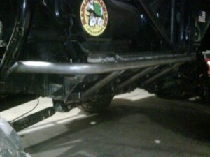

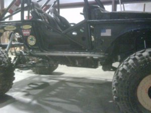

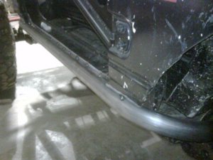

This is a samurai that i've been building piece by piece for a friend. I just finished the rear 4 link this week so I thought I would post a few pics.

Looks like all those parts worked out well, simple and straight foward. Its definitely overkill for his Sammi but he shouldnt have any problems, looks good.
Trey's sammi is the heat... The 4 link is lookin good. I almost stopped in today, saw u working on a red yota (I think), but I actually had work to do today.:shaking:
Yea man they worked great. The only thing I had an issue with was that he didn't have a spot on the frame that was actually flat because of the skid plate he runs. Where we mounted them the frame curves up a little so I had to box the back of the bracket to keep it all nice and clean. Other than that no problems at all. You should come by and check it out sometime.

Yea the guy that owns it (Trey) loves it. We've already had it on the rock pile 3 or 4 times this week. With the rear linked and extended around a foot its a whole different beast. The only thing holding him back now is the missing link double shackle he has in the front, it gets hung on everything. I wanted to link the front too but I think he's decided to go with an all-pro Leaf spring up front with a shackle reversal.

Frame brackets were Poly Performance
Lower axle brackets are ballistic
Truss was trail gear
Ballistic 1.25 joints

I saw it at the farm ride. Very nice. I may have to copy you on the boat side integrated tube design there since mine are a little massaged, lol.
