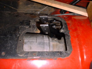

well as much as i like other peoples products, they dont usually meet my needs. So I saved the $100+ and made my own shifter, kinda needed custom to clear the rest of my setup without butchering the tub... Got about $20+ plus my time into em...
