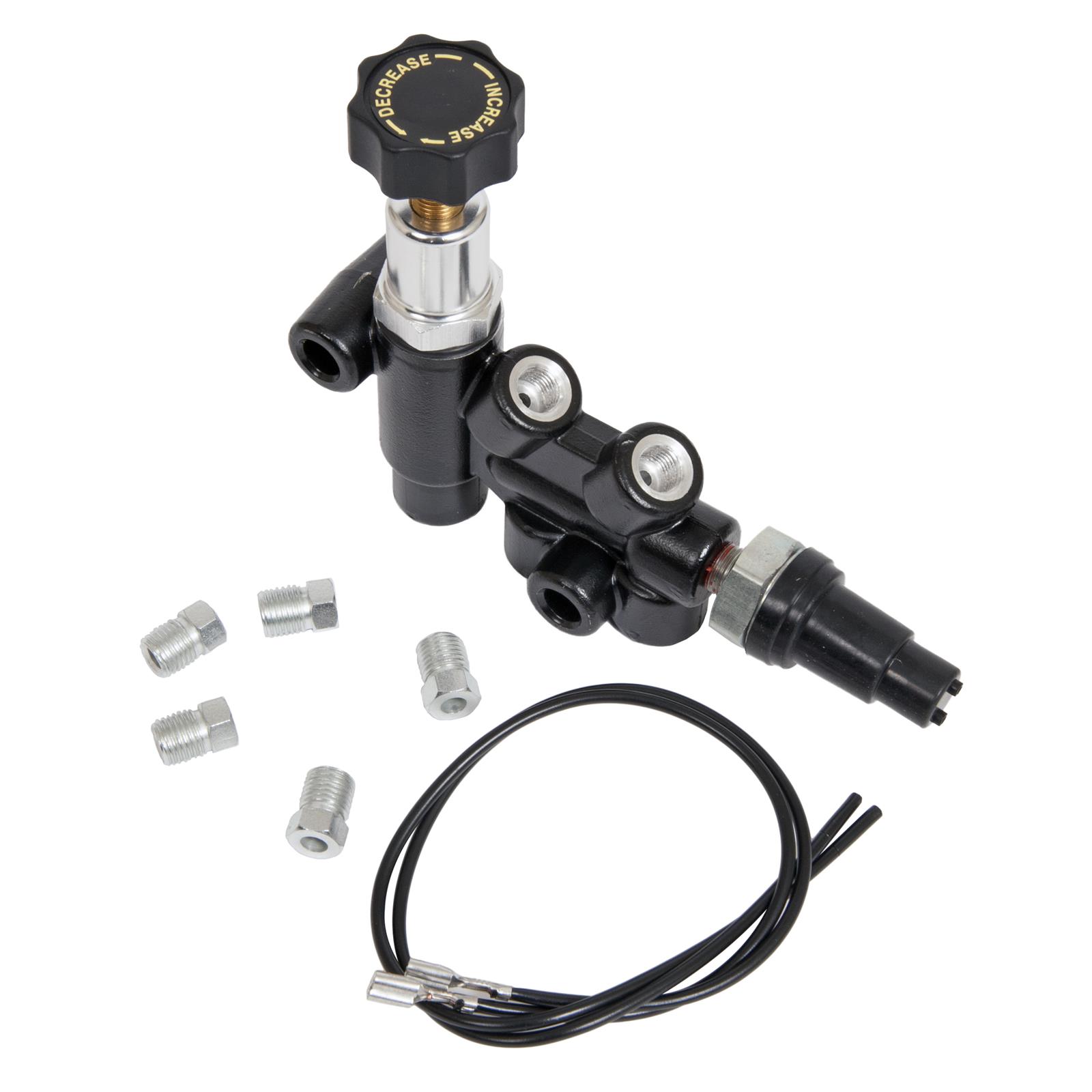

Any recommendations from the group? I looked at some adjustable ones from Wilwood on Summit's site but I really have no clue which one to get. I'm still using the original Jeep one from 1975 and I've often thought I need to fix this. I figure it's a quick bolt in since I'm having to rerun some new lines anyway.
Here's the one I was looking at:

That makes sense. I guess I was thinking for $60 I can have adjustability and possibly give myself a little more stopping "feel" from the rear.

the oem vavle goes out and the replacement is 300 bucks.
The alternative is a Wilwood (I think) kit from Low Range that includes fitting and a couple of pieces of line for way less than half that.
You like the price, plus you can adjust it as needed.
A couples hours worth of work and you're good ... AND you have the added benefit of adjustability.
