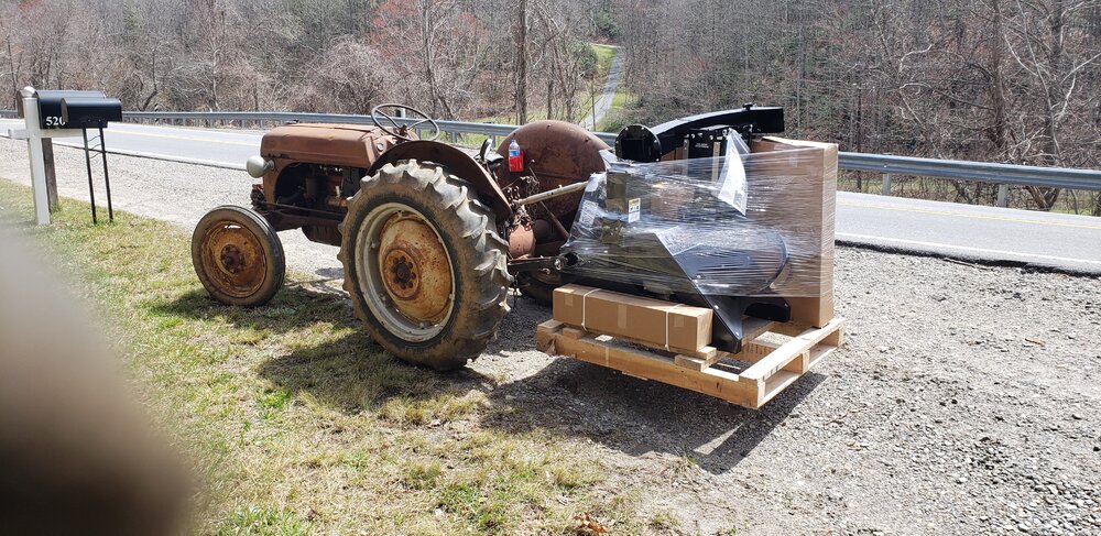

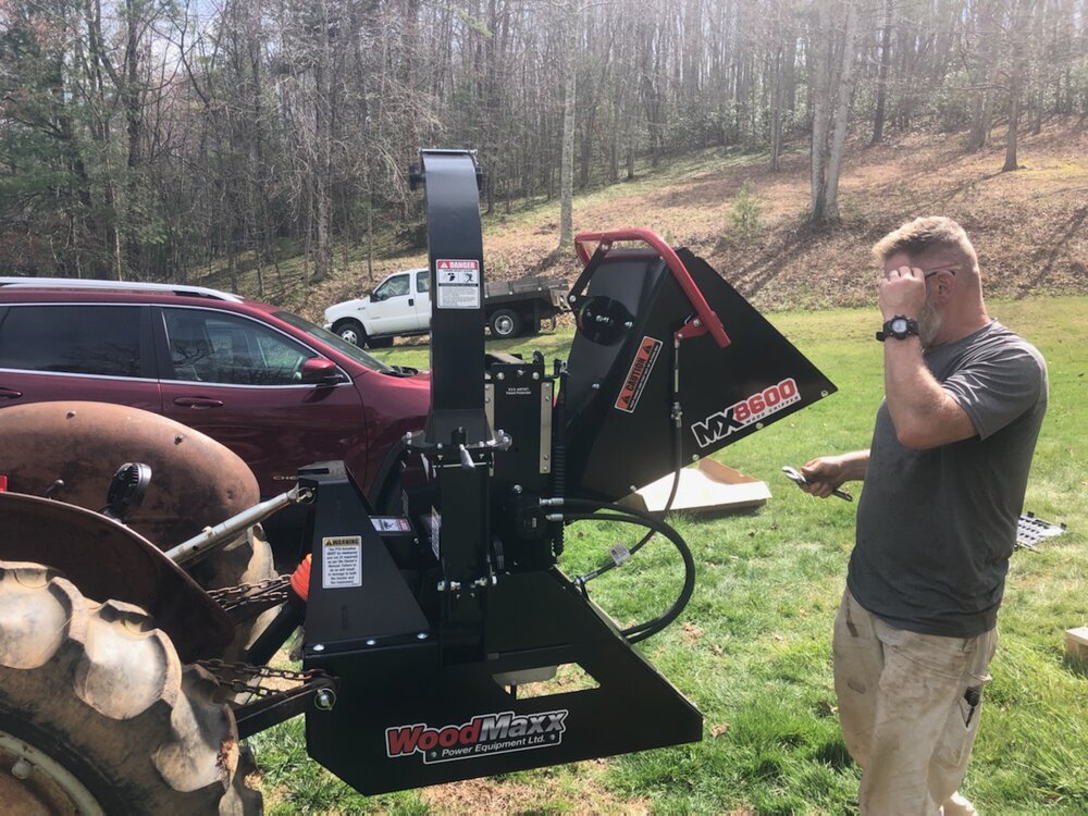

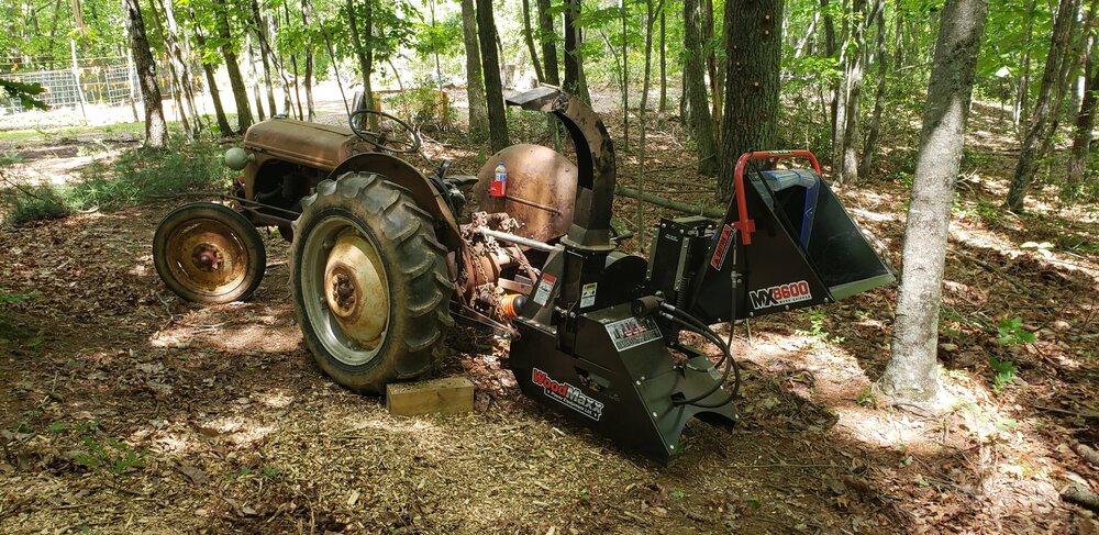

Ended up being OD delivery, right on time, very smooth dealing. Dropped at 1215, pulled cardboard, connected to 3pt, taken to house, and assembled by 1500! Planning to test it out on a pile of brush left by the helo-trimmer in the fall... 20220406_123546.jpg41090.jpeg

Looks like a solid unit. If you extend that toplink all the way out, that should make the chute angle much easier to feed, and you'll have fun until you get tired of it! :laughing:

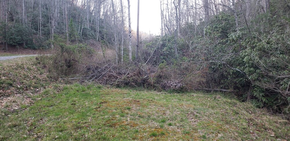

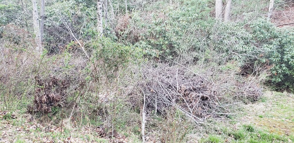

We've got a little over 5 hours on the MX-8600 cleaning up some of the helo-trimmer droppings and some limbs in one field.
Night & day difference over the ol' Crapsman chipper/shredder! While definitely NOT a "commercial" unit, I contend this thing will wear 3 men slap out trying to keep up!
Side note: the 8N burns about a gallon an hour spinning the chipper, which I consider pretty decent considering...
They're a what...10 gallon tank or so? I wouldn't want to spend 10 solid hours shoving wood in a hole. :D Any way you interpret that, I'd be dehydrated and wore the hell out! Chafed too!

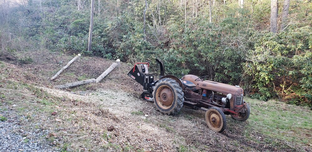

A little over 10 hours now (just completed 1st regreasing, nut/bolt checks, etc.) and it's still doing great! Pretty sure it's time to flip the blades, as we're feeding it LOTS of dry hardwood and there's a noticeable difference in engine load over what it was, but does fine just the same.
Planning to order a new set of blades and ship the originals to @Tom@Hilltop_Machine for a dustoff on his surface grinder at some point.

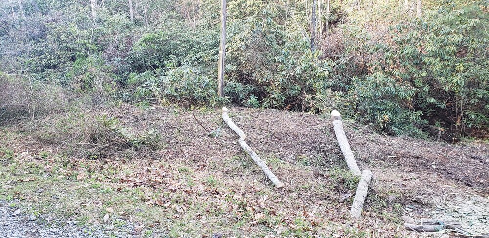

Sunday's 3 hours filled about a 15 wheelbarrow loads that my wife used in the garden "walkways" and cleared about 1/4 acre of underbrush/limbs from the mouth of the trail down to Puddin' Creek... definite visual improvement!
