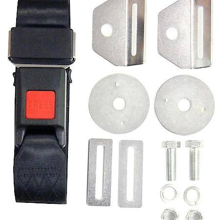

3 - limiting straps are the best and correct answer. You dont necessarily want to rely on the shock to limit travel (though factory does). There should be retainers on the axle side of the spring, and there's some designs that use a tapered guide to make sure the top of the spring doesn't fall out at full droop and to ensure the spring makes it back onto the seat instead of out sideways. You could make some limit straps with old seat belt/HD cargo strap and some clever brackets like come with replacement belts.. (you could use the one factory end of the belt at one end and the slot wrap type replacement end on the other, bonus you can adjust it as needed)
