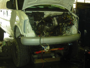

Ok, so Thursday just another crazy day at the oriface, I see a LARGE van dragging an equipment trailer parking behind the shop.
2001 model Chevy G-van with a Quigley conversion ( SWEET !! ) D60 front axle, 14b rear, NP241 Tcase( I think, I haven't looked) . Sittin on 35" Nitto Terra Grapplers.
Engine has a definate miss to it. Go thru the a few diagnostications (technical term) and determine #8 hole is DOA, no compression, exhaust valve either burnt or bent. Oh boy, this is gonna suck, in chassis head removal is a B*tch at best on a van.
SO, we offer up a few different options to the customer, top end rebuild, or crate engine swap.
Customer plainly states that he wants a new engine, what options are there. Stock Vortec 350 swap,or the HT383 crate engine.
Hmm, priced it out, and find that the HT383 is yet to be released/national backorder. next option ( this guy wants some power ) ZZ383 425hp stroker.
Damn, hell yeah !! ( careful what you wish for ! )
So the service writer and cust get things hammered out, we start tearing into the van,
2.5 hours later, we had the old engine sitting on the floor.

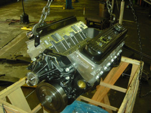

Friday morn, we got the crate engine
ZZ383
All is good till we start adding parts from the old enigne to new.
new engine block is tapped with standard thread for trans, engine mounts (Vortec is metric),and there are a few other issues with the water pump and flywheel (included with new engine)
Then we find that the timing cover isn't provisioned for a crank pos. sensor.
which means the reluctor ring isn't there either. add new cover, and pull reluctor off old engine.
a few other odds and ends and it's finally sitting in the van. will get it running Monday, then determine to what extent the ECM needs to be reprogrammed (dyno run, outside shop) to make it run. ( this was added into the cost)
So much fun, I dunno what I'm gonna do !!

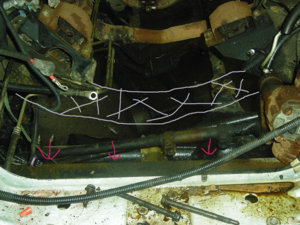

I had often wondered what Quigly did to run the D60 on this van, now I know.
They cut the factory Xmember out ( in pink ) and add a new one across the frame under the steering box ( red arrows ) there is a track bar to handle spring sway, and the axle is running cross over steering.
Very cool van, I would love to own one some day.
![](/proxy.php?image=http%3A%2F%2Fquig1.jpg&hash=04d4a5f5976856b7ec43dc5d35680150)
![](/proxy.php?image=http%3A%2F%2Fzz383.jpg&hash=7e33e227c3c55b6eff801d76cf03ef08)
ZZ383
![](/proxy.php?image=http%3A%2F%2Fquigcut.jpg&hash=a4e936ee1f3599828017c31d154706a0)
