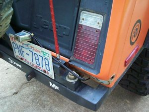

Or you can go the cheap and indestructible method, and use a 1" grade 8 bolt and grease it. How often do you really swing it in and out anyway?
Whichever way you go, do it in double shear. There have been quite a few that have had their trailer spindle shear and let the tire go bouncing down the road...
