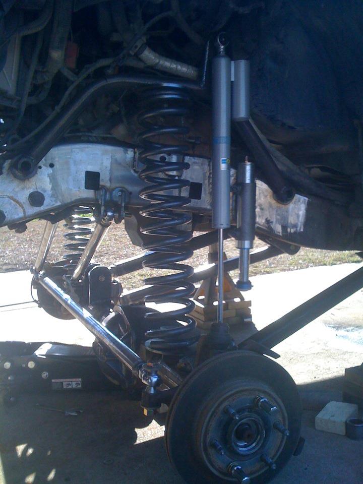

Many of the build threads I’d seen were using a link suspension with coil springs. Well, my 2wd truck already has a coil spring pockets that are big enough to accept a typical 5.5” spring (IFS spring OD is 5.8”) and the Dodge D44 accepts the GM 6 lug unit bearings which keeps the stock wheels and keeps the ABS happy. I can find brackets and tabs from one of many vendors to make just about anything fit anything. The 2wd frame also has the holes already cut for the 4wd steering box which has been utilized in the stock location on numerous other builds. See where I’m going with this?

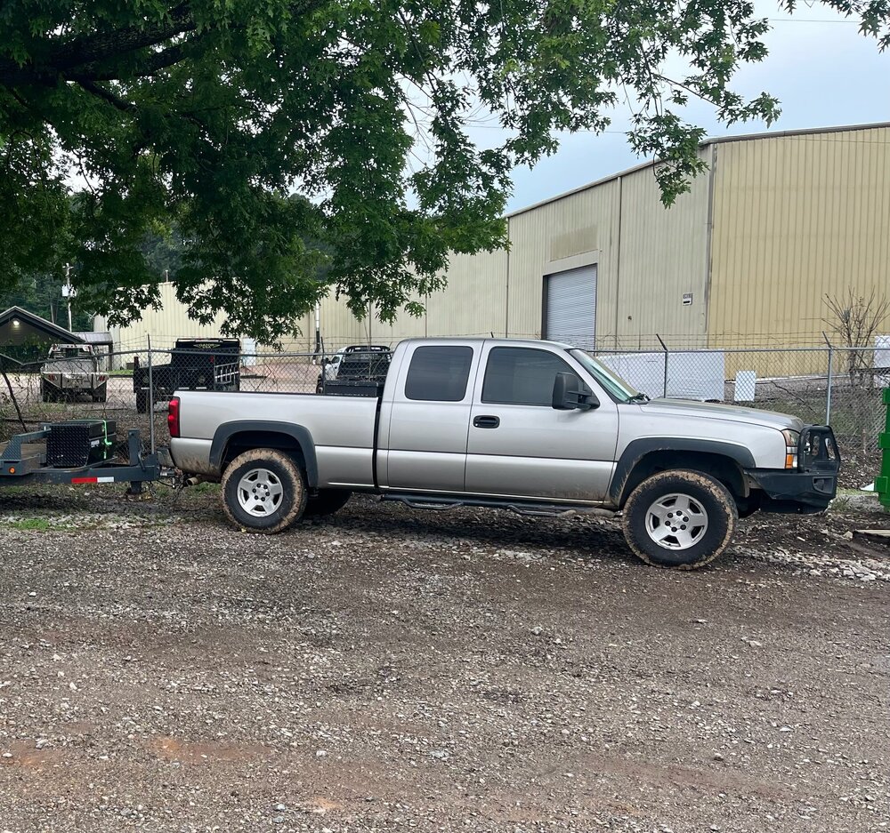

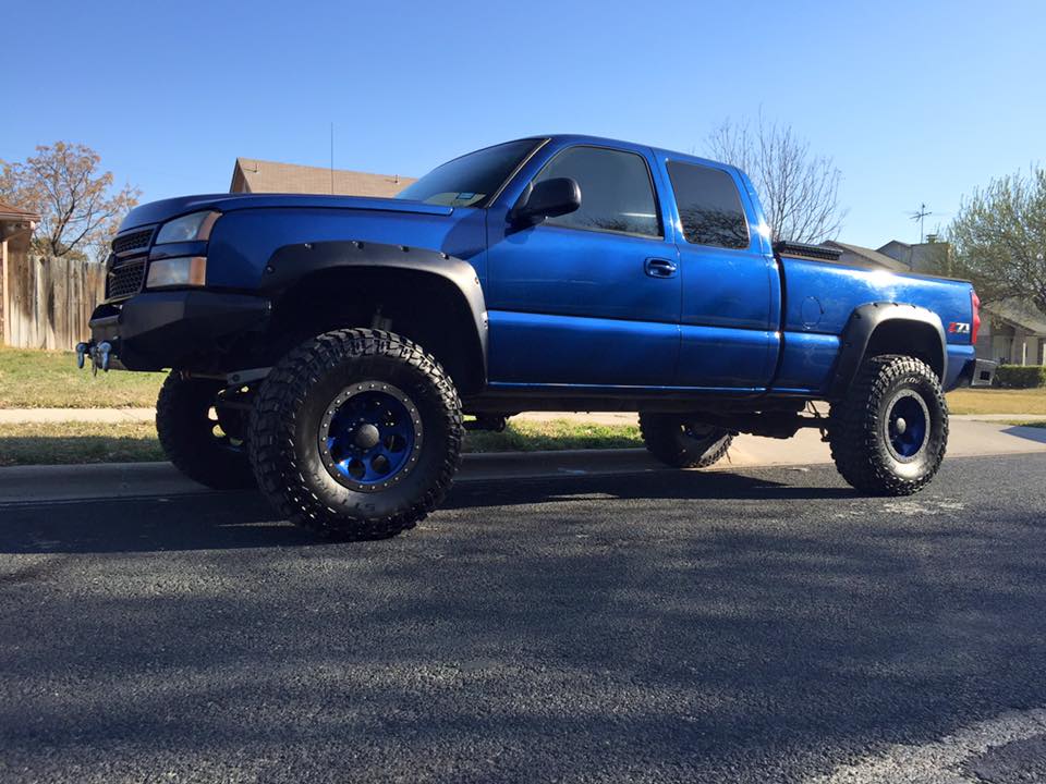

Spoiler alert – this picture is from a few years ago.

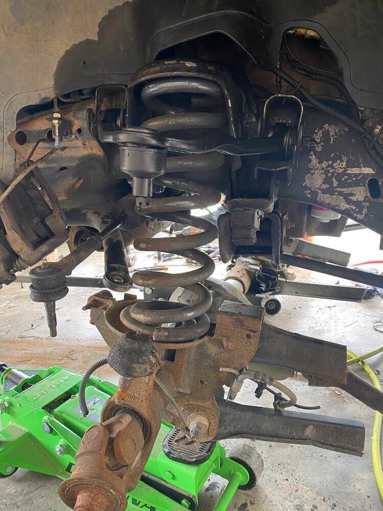

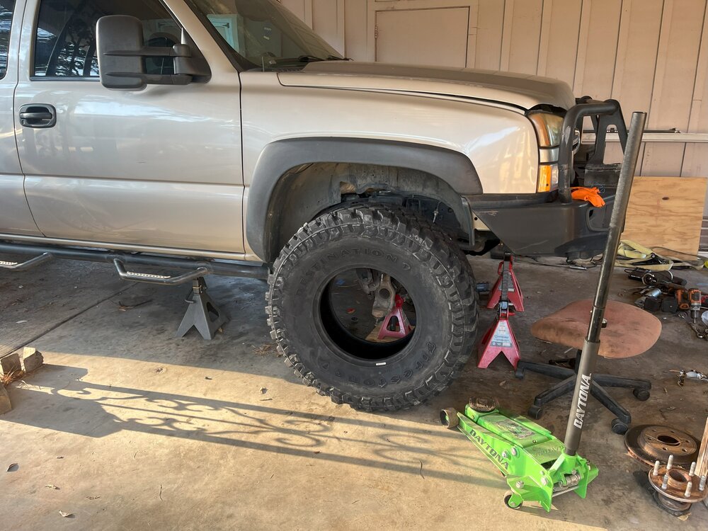

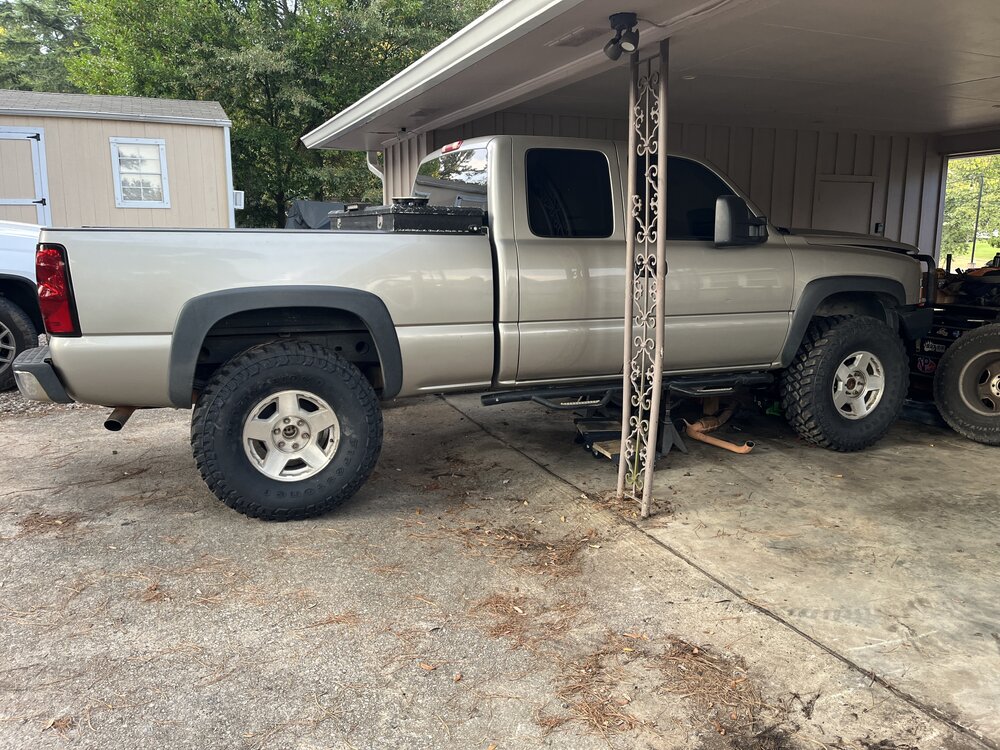

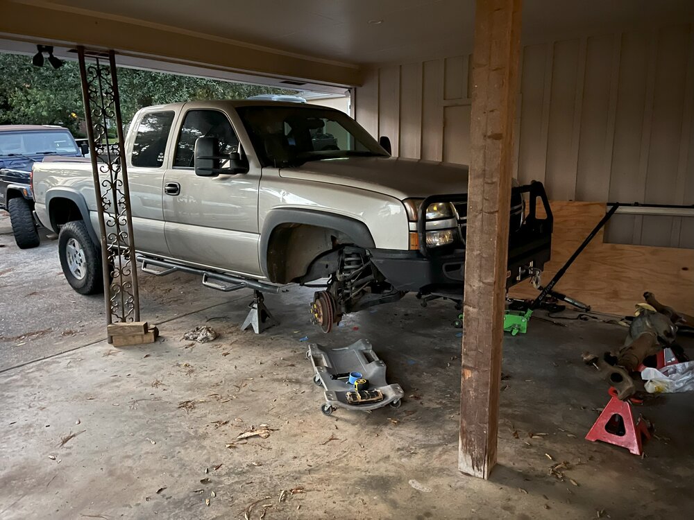

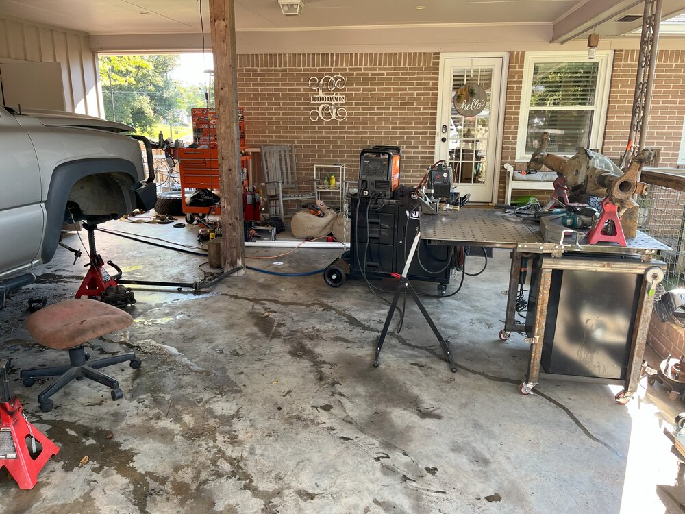

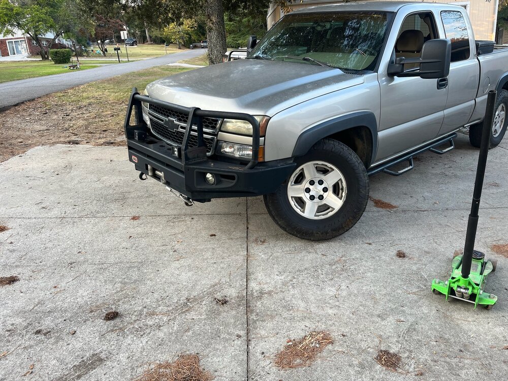

Made a little bit of progress last weekend. The truck is back home, washed and the driver side suspension has been removed.
Yes, this build is taking place in my carport. The plan is to get the passenger side off by Wednesday and slide the axle under it for initial mock up by Friday. I’ll have the house to myself for a few days this week so I’m stocking up on Monsters and Dominos pizza coupons and plan to have the links mocked up by the end of the weekend.

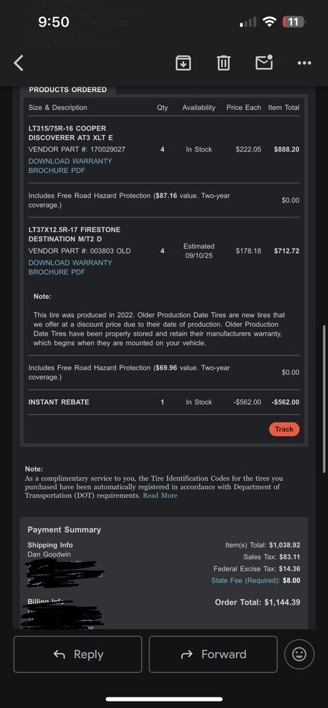

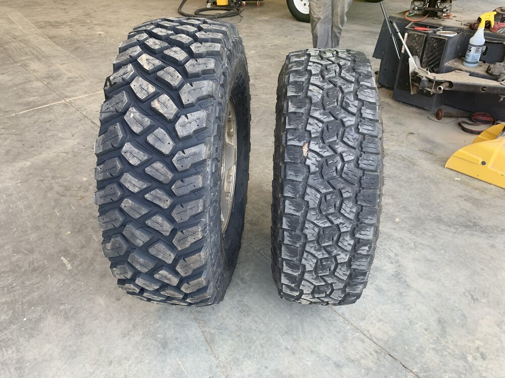

In other news, Tire Rack had some close out deals on tires that I couldn’t pass up. I’d planned to run a set of 315/70 BFG ATs (lightly used off my buddy’s raptor) but those plans may have changed.
Yes, that’s $1,144 for a set of 315/75/16 AND a set of 37x12.50s. This tire deal was a buy first and ask questions later so we’ll see how it shakes out. I’m now planning to build around 37s (which is kinda what I wanted to do anyway). Stay tuned, this is about to get fun!
Dang! I'd have bought em too at that price! :D
I really kept waiting on Tire Rack to cancel the order and this deal have been too good to be true but look what showed up...
And a poser picture with my new rubbers, just because. I like where this is headed.
Now the debate is do I pull the 33" Cooper STT Pros off my TJ and swap to a 35" all terrain? I'm leaning towards yes, but that's a post for another thread.

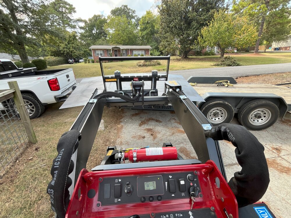

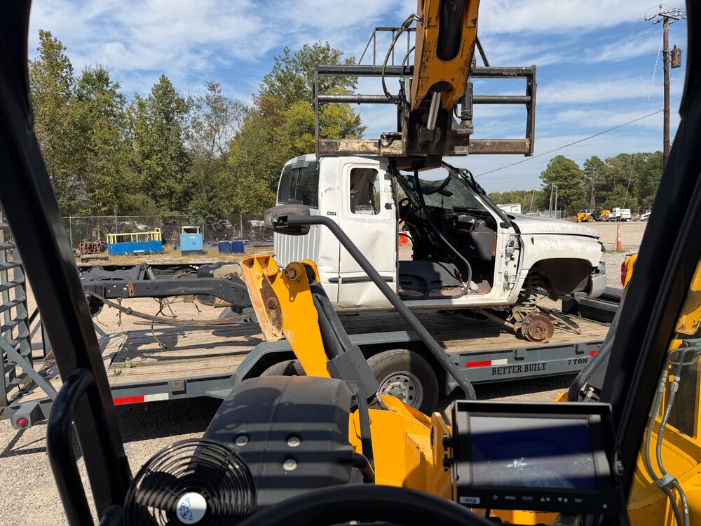

I made some pretty good progress on the truck this weekend. Knowing all the stuff I had to move around I borrowed a Dingo from work to serve as my forklift.
This makes me want to buy one of the Chinese knockoff mini skid steers – this thing is a time (and back) saver.

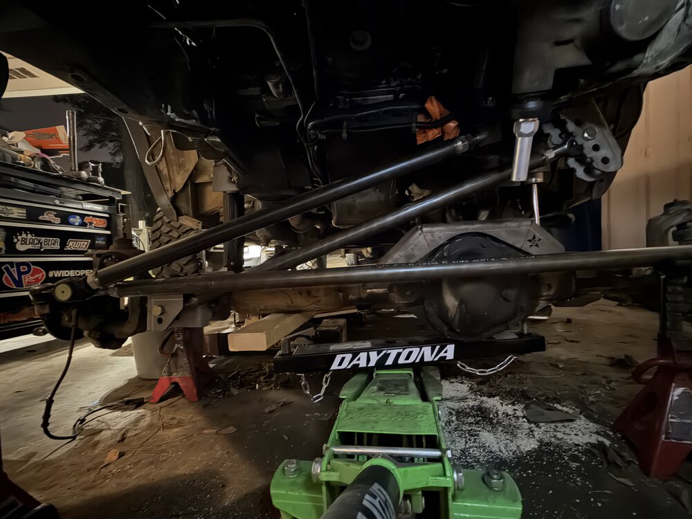

I did a lot of research on how to set up a 3 link and the information was consistent that if you follow the below rules, you’ll have a good end result for the average user:
  • Link separation at the axle needs to be a minimum of 25” of the tire diameter.
  • Link length needs to be a minimum of 2x the wheel travel.
  • For the best on-road handling, the upper link needs to be 70% of the lower’s length.
  • Triangulate the lower links as much as possible to reduce stress on the track bar mount.
  • The upper link needs to be flat-ish at ride height.
I’m not building a 4400 car here, so I set out to build around these guidelines with a 37” tire as the basis for the link separation. Yes, I know the link calculator exists and plan to play around with that before I finalize everything.

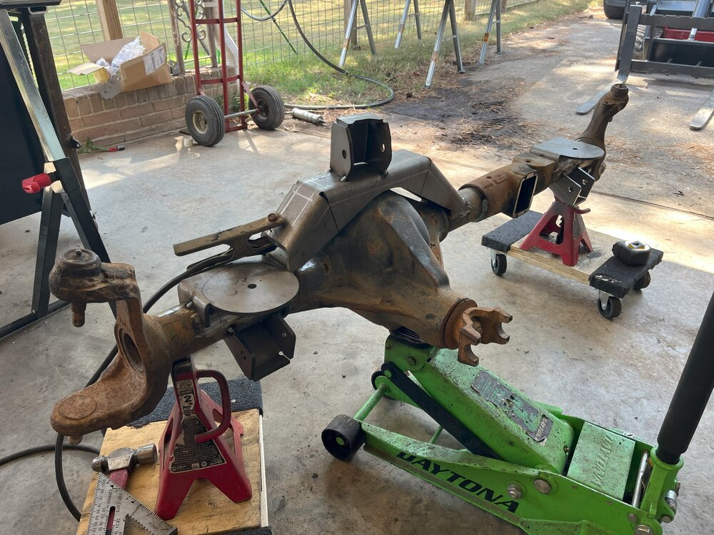

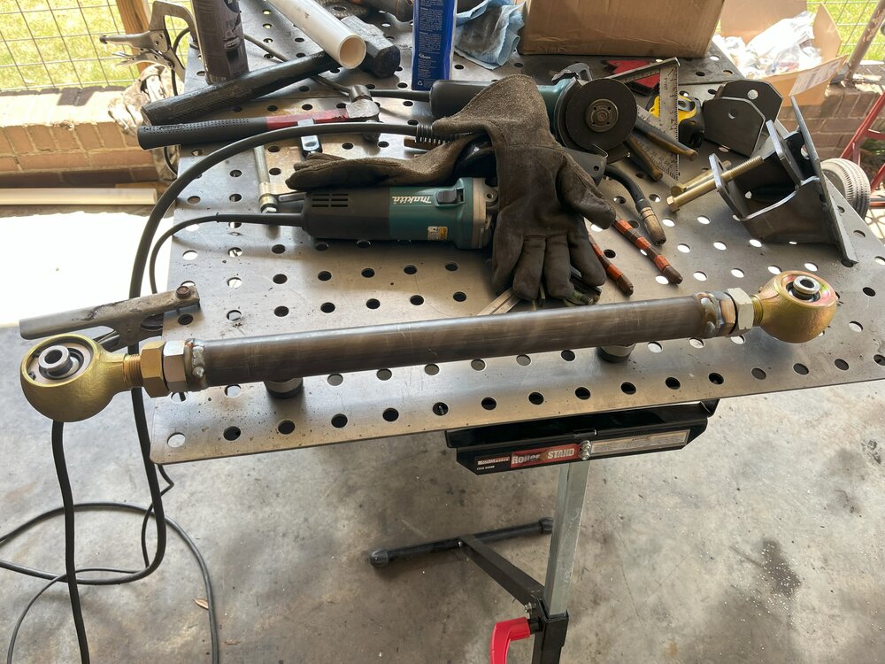

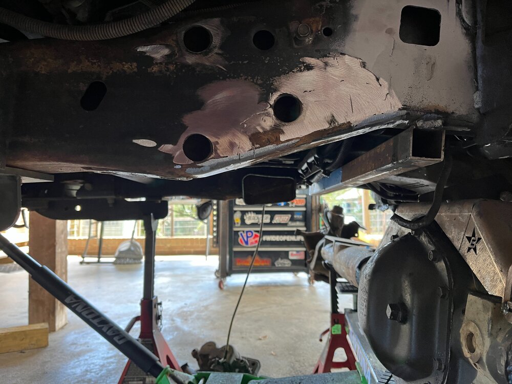

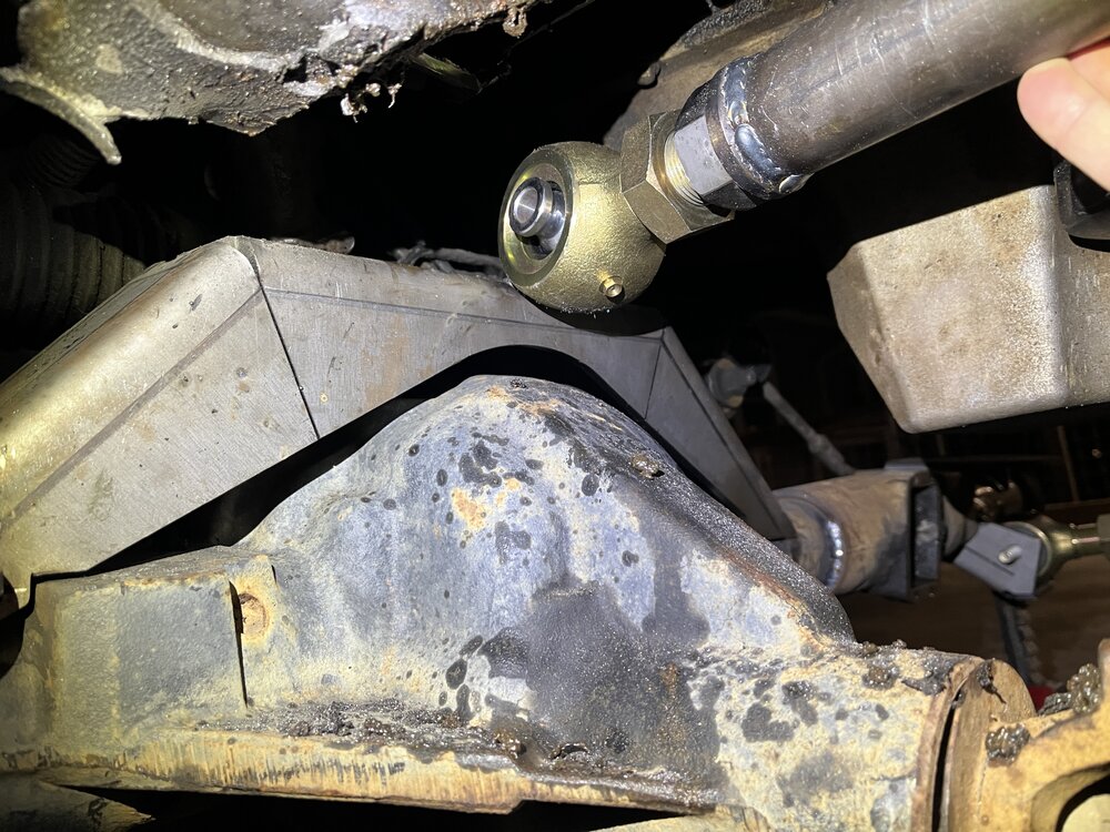

The upper link is 1.75” .120” wall DOM tube with 1.25” Enduro joints at both ends, lowers are 2” .25” wall DOM with weld on Enduros at one end and adjustable on the other. After laying everything out and tacking the brackets on the axle I had this:
I don’t love how much I had to cut out of the truss, but once I get done tying everything back together I’ll be happy with it.
I let the upper frame side mount locate itself as far back as possible and cut links from there.

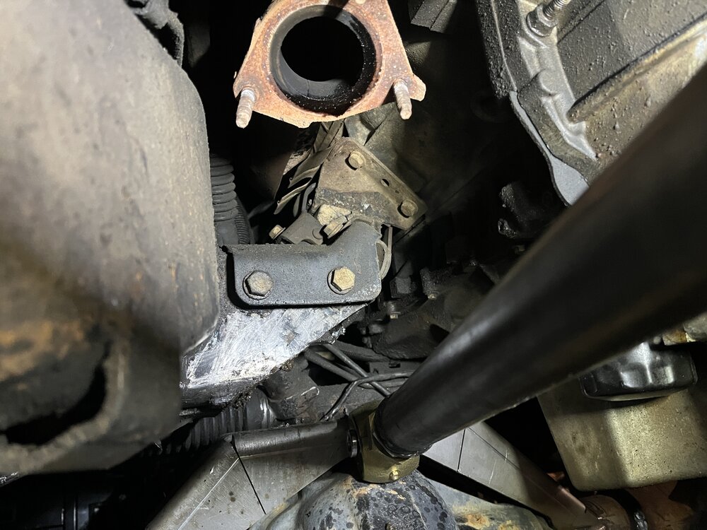

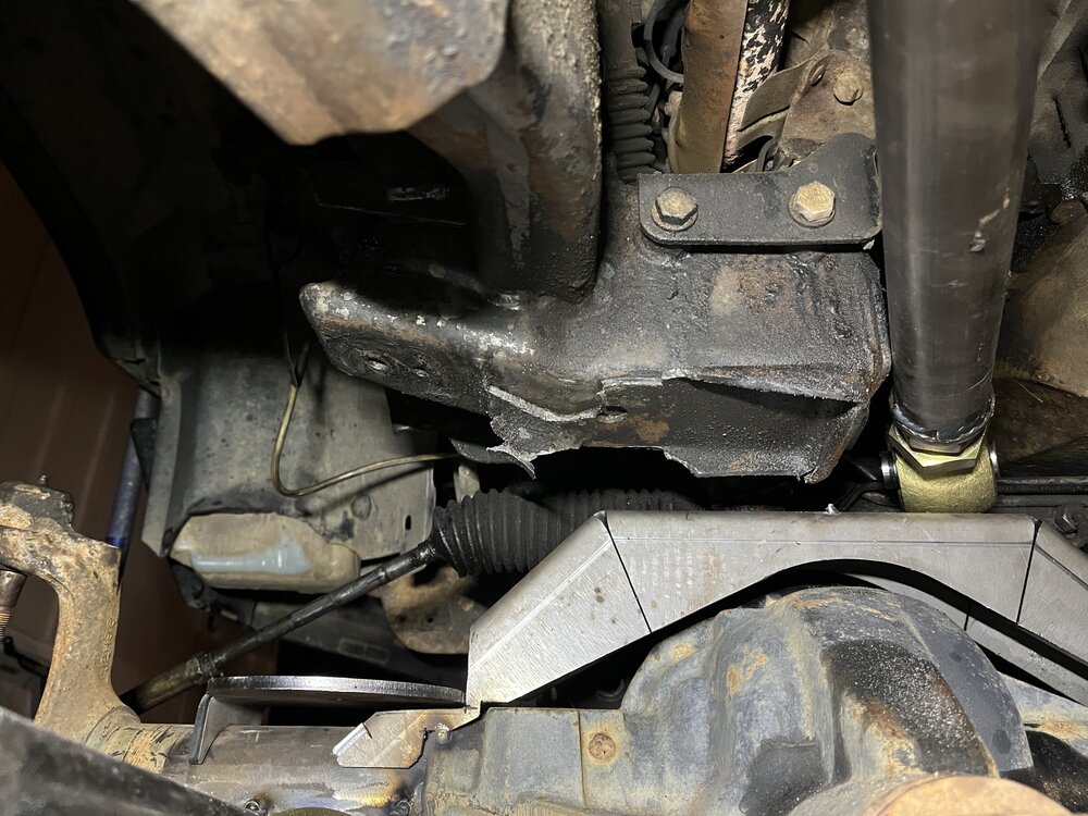

The first issue I ran into was that I cut the lower links too short and they ended up being about 85% of the lower length. Don’t ask me how I goofed that up because I still don’t know. Not the end of the world as I can shorten the upper and move the mount forward to make it right.
The second issue was the axle side upper mount interfering with...everything, especially the factory motor mount.
After laying under the truck for at least 30 mins one night thinking through options I could either add a crossmember to run the link straight back or clearance the mount and see how it shook out.
This left me with about 2.5” of uptravel before the link was into the side of the oil pan (the truck is being mocked up at ride height). I’m shooting for 4” up and at least that much down. After some more staring I realized that I can move the joint back and down on the truss to get all the clearance needed. Something like this:
I’ll tie that mount into the truss and add all the triangles to it this weekend.
Progress feels good.
You might consider going to a .250 wall upper. I know it isnt a offroad rig, but that upper link has alot of force on it. Dont want it bending/failing going down the street.
I may have enough left over from the lowers to make the upper .250 wall. Good suggestion.

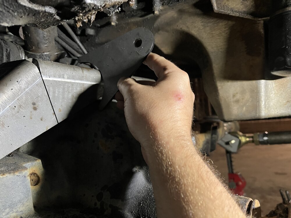

I didn't get anything accomplished over the weekend to write home about. The upper link has been shortened (but not final welded) and mount moved, new upper link mount tabs were cut and tacked into place and the steering rack was removed. I did get 2 of the new tires mounted and installed on the truck at what should be close to ride height:

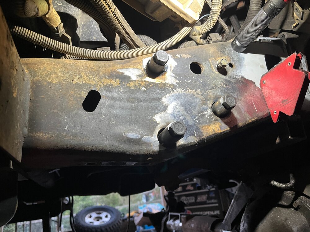

I've done a lot of research on 2wd vs 4wd frames and, best I can tell, the frame rails are identical, with the differences being in a few brackets and crossmembers. Case in point:
The steering box holes are in the outside frame rail of my 2wd, partially hidden behind the LCA / steering rack crossmember.
I ordered some 1" x .5" wall DOM stock to use for the inserts, drilled the holes to .5625 and was able to tack a stock 4wd steering box in its place. I've had this box kicking around for legitimately 10 years waiting on this project. :lol:. It took a solid day to get the crossmember cut out, Frame rails cleaned off and the box tacked in but felt like a huge milestone.

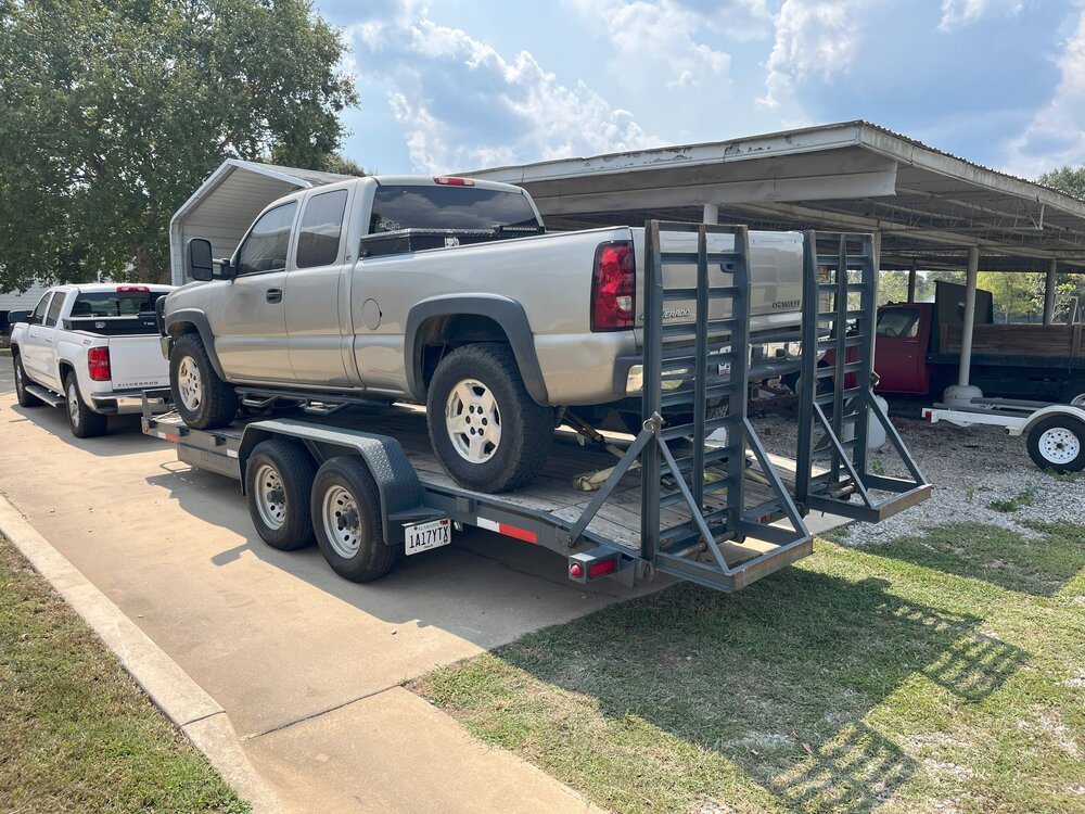

Needless to say, the truck did not make it to the Altima 600 at the Freedom Factory back in October as it was nowhere near done. I ended up having to take my 2015 Silverado anyway since I had to haul a car, 15kw generator and 3 buddies with me.

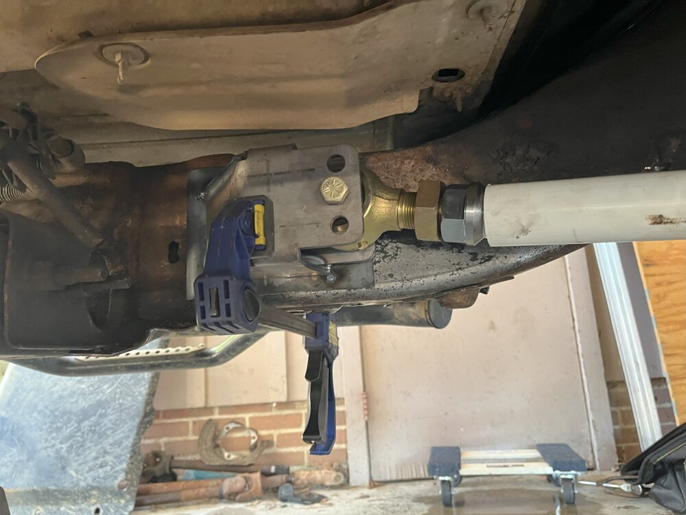

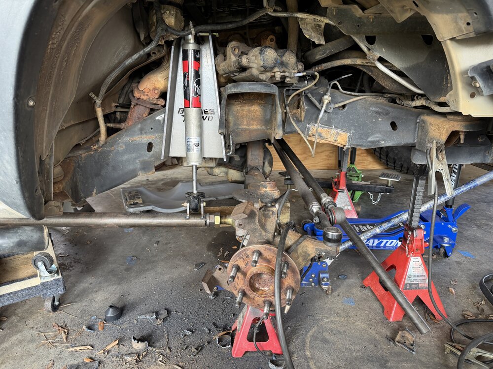

Back on the truck, I got the passenger side shock tacked in and the driver side is within 30 mins of going on. Frankly, I don’t love the placement on the link (rather have it on the axle) but this is what I had to compromise with. The shocks are a Fox IPF shock off a Gladiator Rubicon with 8” of travel and the towers were a project for my TJ that I haven’t gotten to yet. I used a strap to pull the shock with 4” of shaft showing, set it in place and tacked the tabs in. The truck is sitting at ride height so this should give me 4” up and 4” down travel (probably a little more with the motion ratio of the location on the link. Bump stops and limit straps will be used as needed. I ended up changing the lower mount and rotating them 90* so the bolt was perpendicular to the link.
Next was to get the track bar and driver side shock are tacked in place. Initial cycling of the suspension is really promising with only a touch of bump steer when it nears full droop. Still have a lot of checking to do before this is all burned in for good, but I’m pleased with this so far.
The shaft on the steering box is an attempt to kill 2 birds with 1 stone - I need to replace a crossmember that was cut out and also want to brace the steering box. I ordered a 94-99 Ram 2500 steering box brace from the jungle website and am going to cut it up to work with my application.
