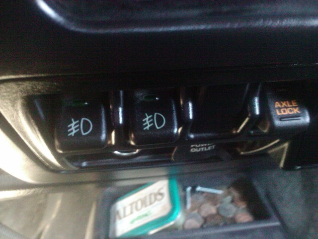

Okay, lets start off and get this out front, I'm a TAD eccentric when it comes to some things.
In my LJ switch panel I've swapped in 2 Cherokee fog lamp switches for my future offroad lights and rock lights (I wanted a clean look)
In looking around at various projects I found an extended idle switch from the police package Cherokees.
When wired up correctly it will bump the associated police packaged 4.0 idle up to about 1000ish rpm, it was for running police lights and all the extra police "stuff".
