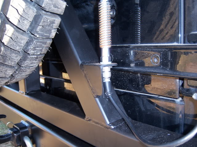

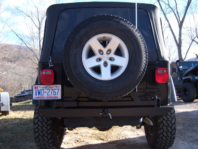

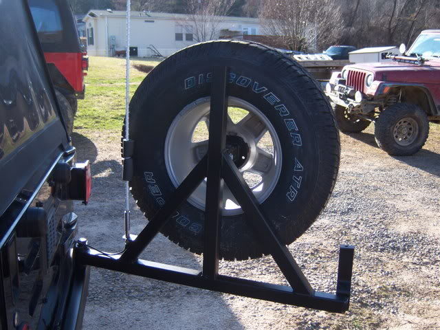

last week i built a set of bumpers for a rubi. here are a few pics. i built them from 2x4x1/4" and the tire carrier is 2x2" the funny looking mounts on the front are for a tow bar he is going to use behind his rv.

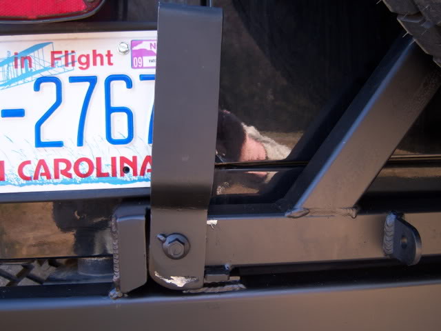

on the next one I would suggest a gusset on the pivot for the tire carrier.
Very nice work welds look good.

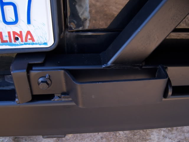

thanks! i always put everything i have into the parts i build for people only if i put as much effort into my own junk. i had to think hard about putting a gusset on the pivot but it would only give good support in the closed position and i have a rub block welded on top of the bumper to support any sag. i also planned for the load and built the carrier high on the latch end so that the tire weight will bring it down to the right position over time . i put my 246# butt on it and it opend and closed perfect . the bolt is also 8" long so it is supported through the entire bumper not just the top.

nice job on the swingout, those ones that use a trailer spindle are totally gangster. that setup looks much better
thanks . i had thought of using the trailer stub just to make it easy i just could not bring myself to do it i dont like my parts looking like they were put together at a hardware store. and its better if i just tig the hub and bearing races from scratch so i can get it low to clear the door hinge. i have a high lift mount going on a carrier now ill post pics when its done. i am thinking of a skid to go in the hitch with a roller to make it smoother walking off ledges .
