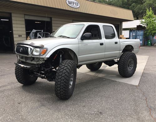

They apparently have a kit for a Dana 44 as well, just for reference. There's some pictures on it, if you want to look or get ideas. Says 5.5" of lift. Not sure how low you're trying to keep it.
WFO Toyota Tacoma '95.5-04 BUILDERS SAS Kit - using D44 | Toyota | WFOConcepts.com
This one is on an SD 60 and 40s. Keeping that in mind, it looks pretty low. At least, not toooo high anyway.

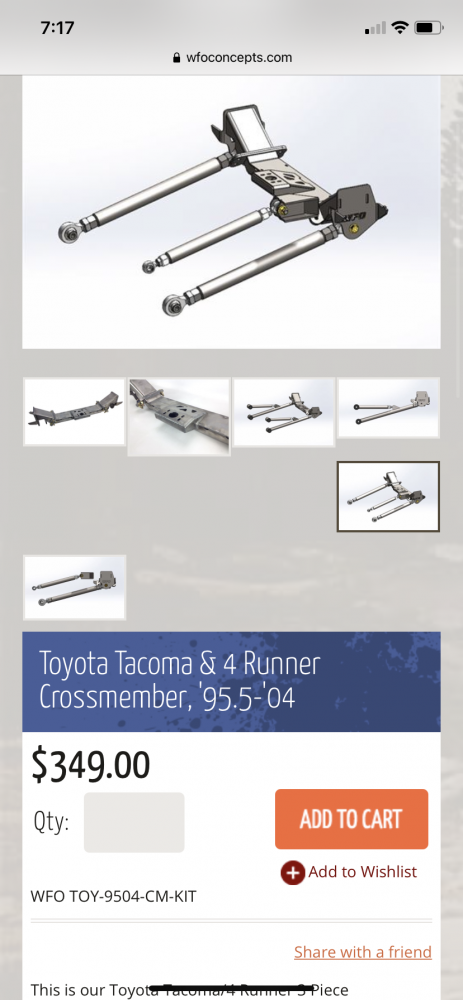

After getting deep enough into mine today to realize the stock transmission crossmember will have to go, I’ve gone back and looked at the WFO crossmember and am leaning towards using it since it has the lower mounts built in. Will need to go back and do a little measuring and see how long that would put the lower links.
It's pretty sexy, ain't it?
Depends on much it needs to be modified to work with dual cases. But even so, it looks like it would simplify a couple of other things.
I feel like you could definitely call them and ask. I'm sure they've put some thought of stuff like that in to it. I know they make the crossmembers for the 2500HD trucks to they'll clear an NV273 if people want to do that swap.
